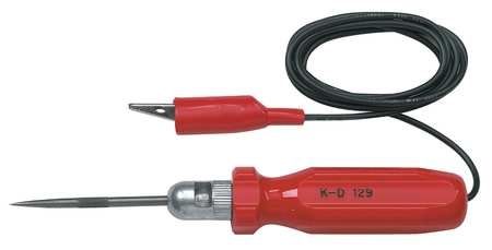

Get yourself a volt/ohm meter or a cheaply pick lite. Turn your parking lites on and go find the hot lead. That's the one you will tie your tag lite to.
