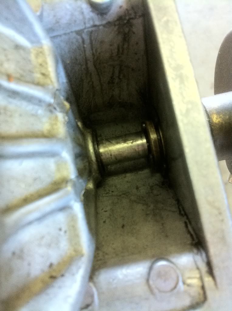

Skip te posilock and just permalock the fork over. I know dodger did a writeup a while ago but I came upon the same results by just messing around with it. You need to lock the form over like this:
So if you slide that actuator over, will it just stay in place or do you need to add some hardware? It seems like if you slide it over it would slide back during daily driving.

Nope. Remove the clip holding the fork onto the shaft (that slides) and lock the shaft in place essentially immobilizing it and sandwiching the fork into the locked position.

Originally Posted by seattle_yj View Post
From what I could tell its about 150 bucks and not too difficult to install.
A brand new vacuum actuator was $89 from Advance, the Zone one required taking your old one apart and putting parts to the new one... But I recommend Canman's way or the one piece.

The front driveshaft WILL spin if you have a solid shaft on the passenger side. You'll have to get your shaft balanced if you notice any vibrations.

The permalock will take the vacuum out of the equation so you only have to worry about the mechanical aspect of the transfer case going into gear. If you leave the wires intact t will say 4x4 all the time but it's not necessarily in 4 wheel drive. You may have to get your front shaft balanced if you lock the fork up front

After you decide which method to make a solid front axle, you can change out the vacuum switch on the transfer case and use an electrical one from a mid 90s Cherokee to have your 4X4 light work when you engage the transfer to 4hi and 4low. It will cost about $20 for brand new stuff or about $5-10 at a junkyard.

I tried 2 different posi lock cables, returned them both as the sucked and would not engage properly or stay engaged if it actually got it engaged.
If you have plans to put a locker up front, that is when you change out the axle to a one piece as you will already be taking it apart otherwise do it Canman's way.
Also if you have the locker in the front you won't need the light as you will easily be able to tell if you are in 4wd by the way it pulls.
