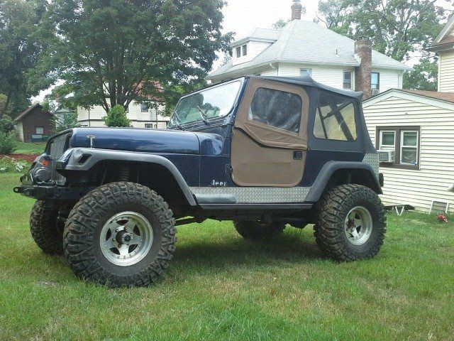

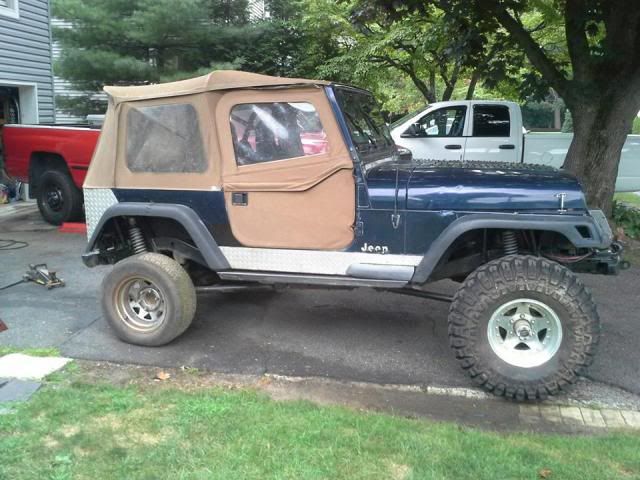

Figured its time for an update I've been busy all summer chasing down problems and found a little time to wheel. I had a fuel pump take a dump on me, broke the frame in a couple spots and managed to wear out the drive teeth of a Detroit in the 8.8.
So now with a fresh pump, locker and starting to plate the frame the jeep its back in action. I went to the local tough truck challenge this year and came home with a 1st in class finish and 3rd overall.
Street racer mode trying to figure out what was up with my Detroit after Eaton's tech support was completely useless.
[/IMG]
All cleaned up after 6 hours of power washing and a new to me black top.
[/IMG]

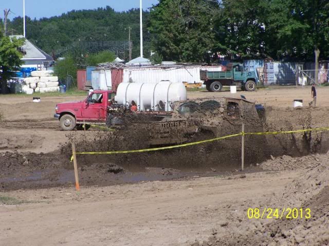

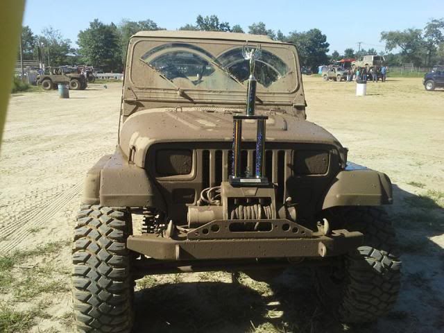

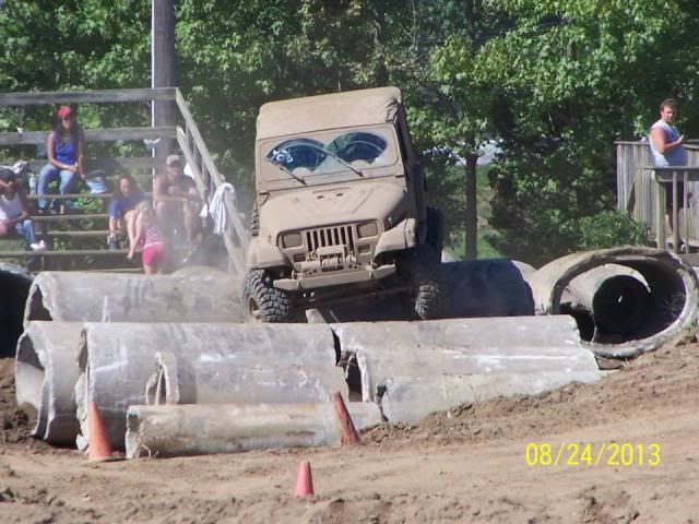

Finally got some pictures from the comp.

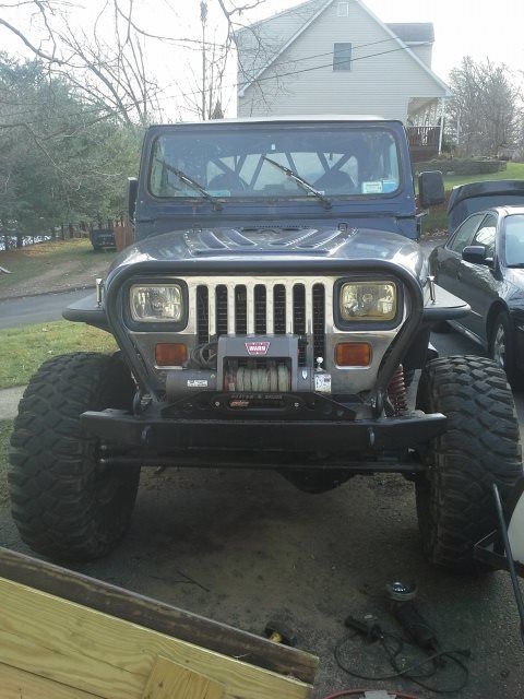

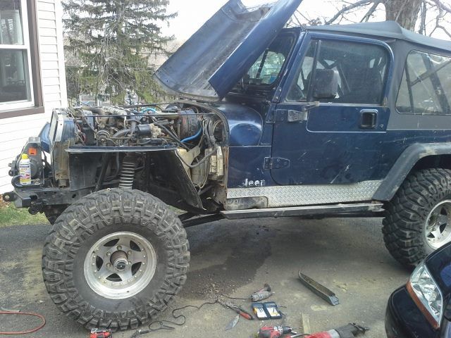

I finally got some free time today and started installing a pair of tube fenders to replace my dented/cracked stockers. I went with smittybilt's no flares cause they're cheap and I'm not fond of steel flares. The plan is to section a tj flare and attach it the the tube fender for a unassuming swap. Here's the only picture I got today before it got dark.
My build:

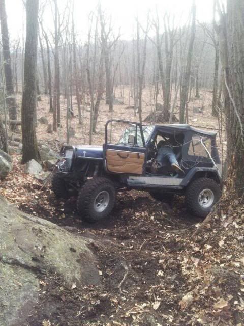

I got the tube fenders on and all buttoned up this weekend. The first side took awhile being too careful. By the time I did the other side I was a pro and just hacked off what I needed to. I aslo welded on a grill hoop that had been hanging in my garage for awhile. We're debating if the fenders should be tied to the hoop or run a tub alongside the fenders to sliders. We'll see for now Im happy with my tree resistant frontend.
Also took it out for some sunday funday and with the recent rain/leaves everything was a challenge requiring rev limiter attempts. On one climb I got sideways and jammed into a tree forcing me to break out the new winch. It dragged the jeep without a whimper so I could back down the hill.
