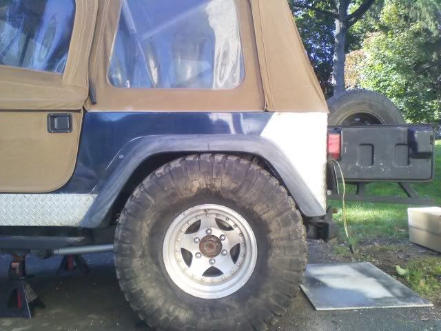

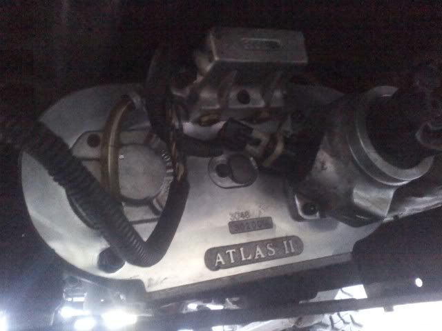

I've been busy tearing it apart for paint all weekend and installed my atlas. The atlas install was straight forward removed the 231 and slapped up the atlas. I had to grind a hair off the trans mount bracket to clear the tcase but nothing major. It clears the tub/bellypan like a glove with 1/2"-3/4" of clearance all around.
I also started chopping the tub to move the flare back to hide the 3" stretch. There's alot left todo this week mainly the tank issue, driveshafts, brakes and torque everything down.

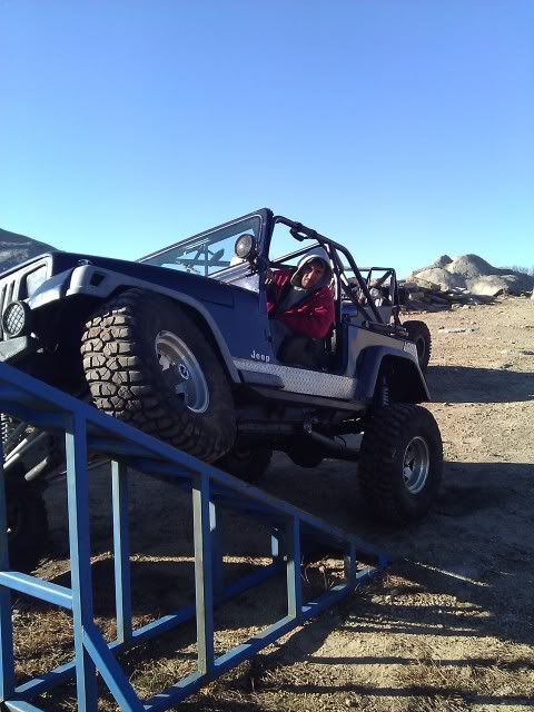

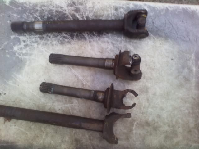

Its a driver!!
I drove it for the first real time this weekend 3 hours to RC. The suspension and atlas worked amazing. The coilovers really soak up the bumps. The waggy 44 didnt fair so well though. I broke both front shafts and ujoints making for as whopping 20 minutes of wheeling. Heres the few pictures we got
In the parking lot getting ready to FAIL
ON the ramp checking clearances
Doin 75mph broken on the way home

Man that sucks.. If I remember right you didn't have chromos in the 44 yet..?

Nope no chromos. Might get some though.
After his broke we jumped in my buggy and went back out. Not long afterwards, I broke an axle joint in my 60 that took out a chromo stub shaft, and my last stock inner. Today was a bad day for axle shafts
Yea just stock shafts and joints that broke. Some ten factory shafts and excaliber joints should be here this week to replace the mess in my front axle. I'm going to pick up a set of stock shafts as spares if I can ever find some around here. My frontend should be set for 35's.

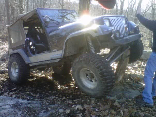

I got the new joints/shafts in and all buttoned up. So we took it today to a local friends property and beat the balls off it. Everything held together fine without any mechanical failures. I have to round up some pictures and videos from everyone. Here's the one picture that I have where I launched up a hill caught air and landed on a stump with my tierod. Chainsawed the stump and backed off it
