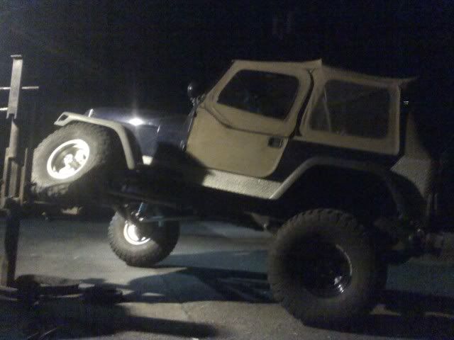

Went to a friends shop tonight and did a little goofing around on the airjack. Sorry the pictures are dark and from my cellphone but you get an idea. Hopefully this sunday I'll get some decent action shots.

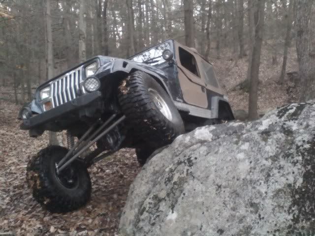

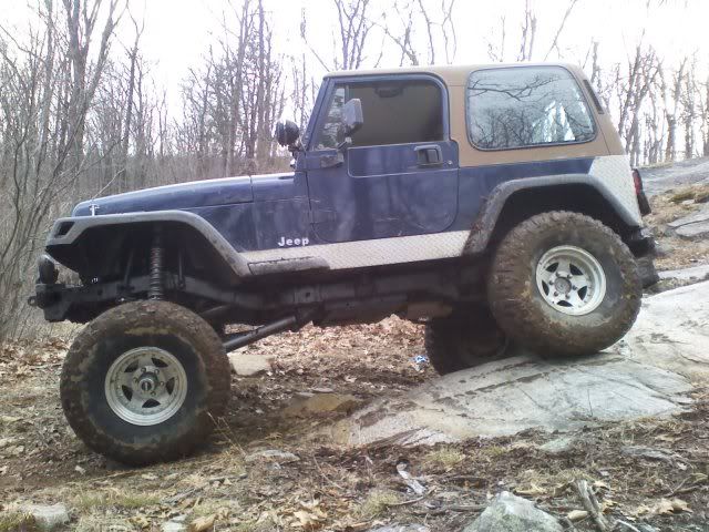

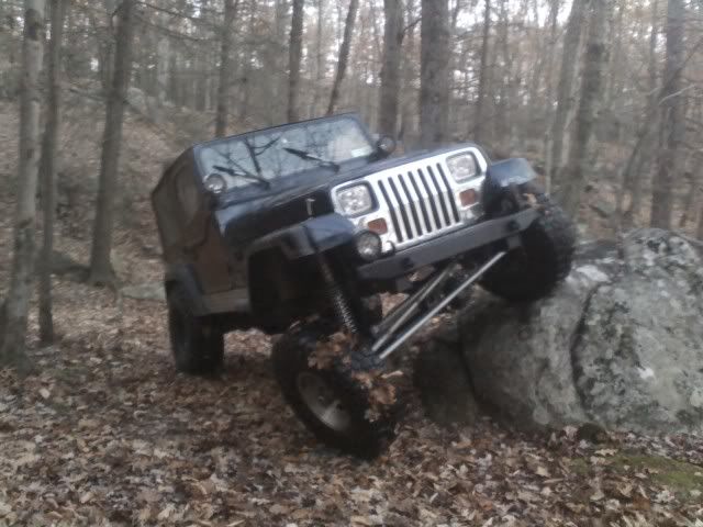

Took the heep out for a short trail ride afterwork today. It did great no more wheelhop and finally being completely locked up is amazing. The front suspension soaked up the bumps very well but the rear didnt fair aswell. I got a little crazy and ended up breaking the shaft in one of my rear bilstien 5100's. I havent liked those shocks since day one and it actually rides better with only one rear shock now go figure. So my goal in the am is to put my BBCS in the back to get it ready for some wheeling this weekend. I got a couple flex shocks on a rock to coilovers clear the framerails by almost 3/4" at full droop for those that asked.

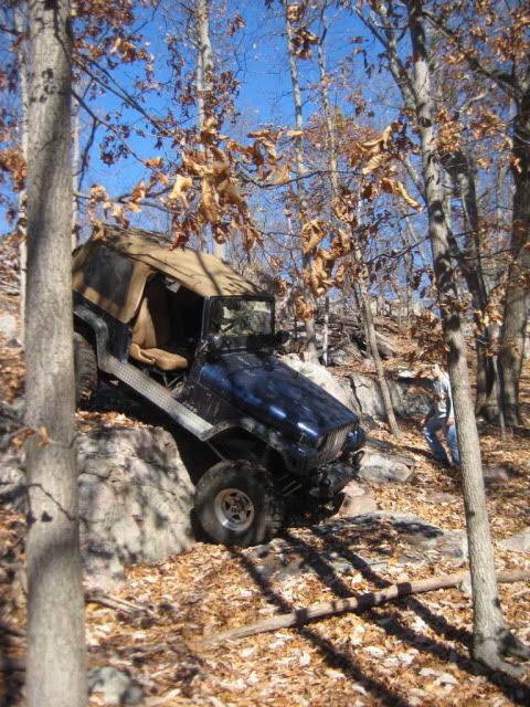

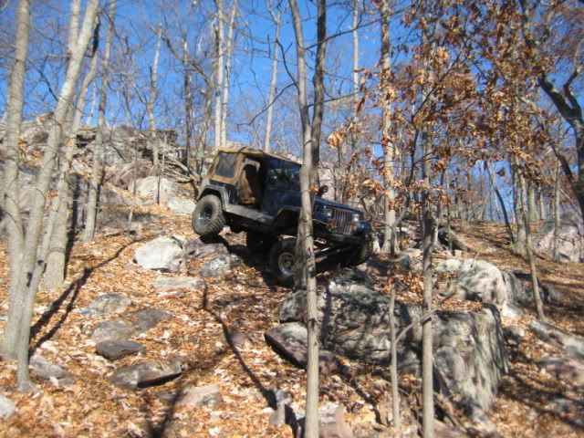

Here's a couple pictures from the lasttime out it worked very well despite a ujoint cap walking out my front driveshaft yoke endeing my day. I've also been driving it on the street and it handles way better than before. Got a new list of todo's make new sliders, strap my brakelines down and fix a pita axle seal thats leaking.

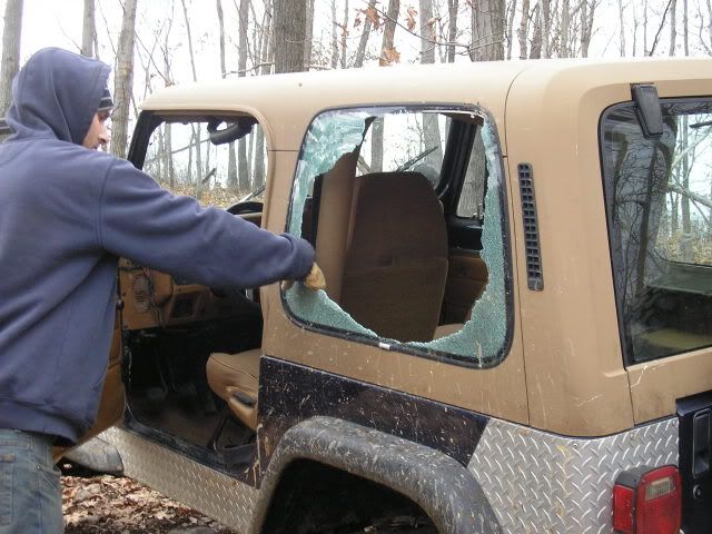

Filled up the front end and took it out this saturday. I'm getting pretty used to how it handles and climbs. Without front wheelhop it really climbs alot better I was doin things that wouldnt even try with my old set up. I did have a few casualties though, lost the air filter on my arb compressor from flying down a couple fireroads and a tree jumped out and bit my hardtop.

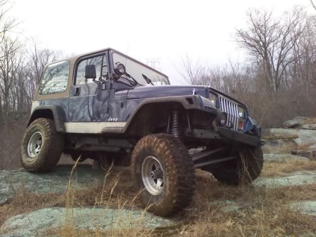

So now that I'm happy with the front I'm realizing how bad the rearend actually works. The rear leafs are pushing the front around and are hardly move in comparision. The plan is to link the back in the spring we started measuring for brackets this past weekend. Plans are to push the rear back
2-3"s which means now I have to deal with the tank being in the way. Anyways here's a couple pictures from the last couple times out.

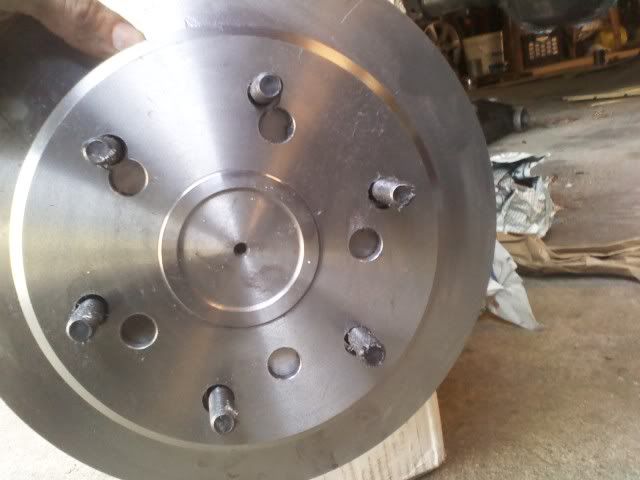

I'm the owner of a 6 lug 8.8 now courtesy of some dutchman axles. Here's a picture of how the stock 8.8 rotors drilled to 6 lug turned out.
