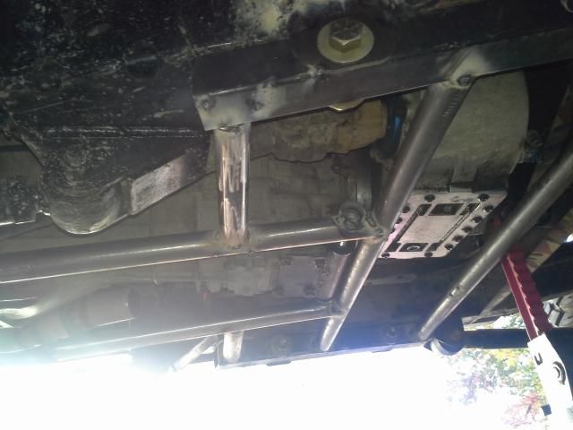

After working like a maniac all summer while trying to deal with buying a garage to sleep in aka house ive finally found some time to work on the heep. I still have to find a pcm since mines toast. Got around to finally attacking my B pillar tie in disaster. All the crushed tub mounts have made for any interesting afternoon of chopping the floor out. Hopefully friday ill get a chance to start on my new lighter 2 piece belly skid. Hefting 3/8 plate is getting old and I scored some 3/4" uhmw from a buddy for free!
My build:
ssyj94 is offline
post #165 of 230 Old 10-04-2014, 11:54 AM Thread Starter
ssyj94
Posts: 1,199
Made progress on the new tube belly pan all welded up just have to weld the 30 tabs to for the skid and cut the Al/uhmw. I added a couple more cross tubes and seems very sturdy. Its great not having to heft 3/8" plate or deal with busted nutsert.

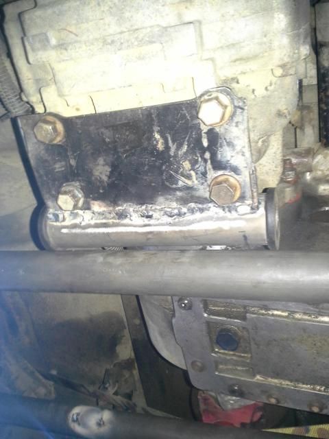

This what I came up for a trans mount couple leaf spring bushings weld to the oem cut mounting plate
