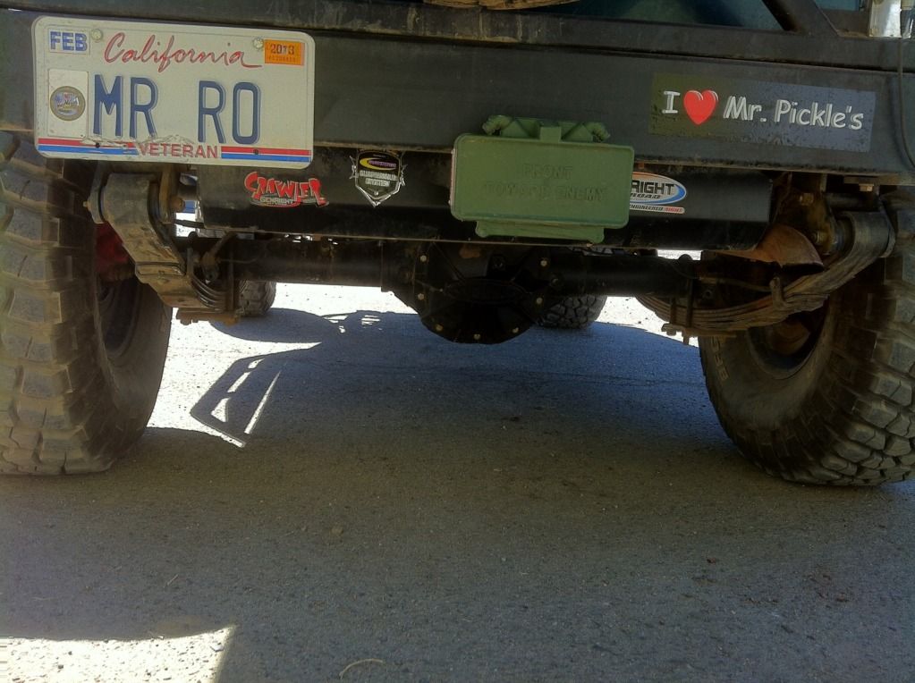

I just did a 1" body lift, and was thinking of raising the tank. The gas tank hangs down pretty low in the rear:
This isn't my Jeep frame, but it is a YJ. I'm sure mine is similar...there seems to be a nasty frame crossmember right at the tank
It looks like some cutting of that crossmember would be required. Along with shortening the stock skid 1" and then rewelding the skid (or making a new shorter, stronger skid).
