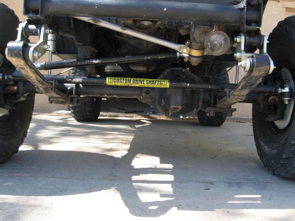

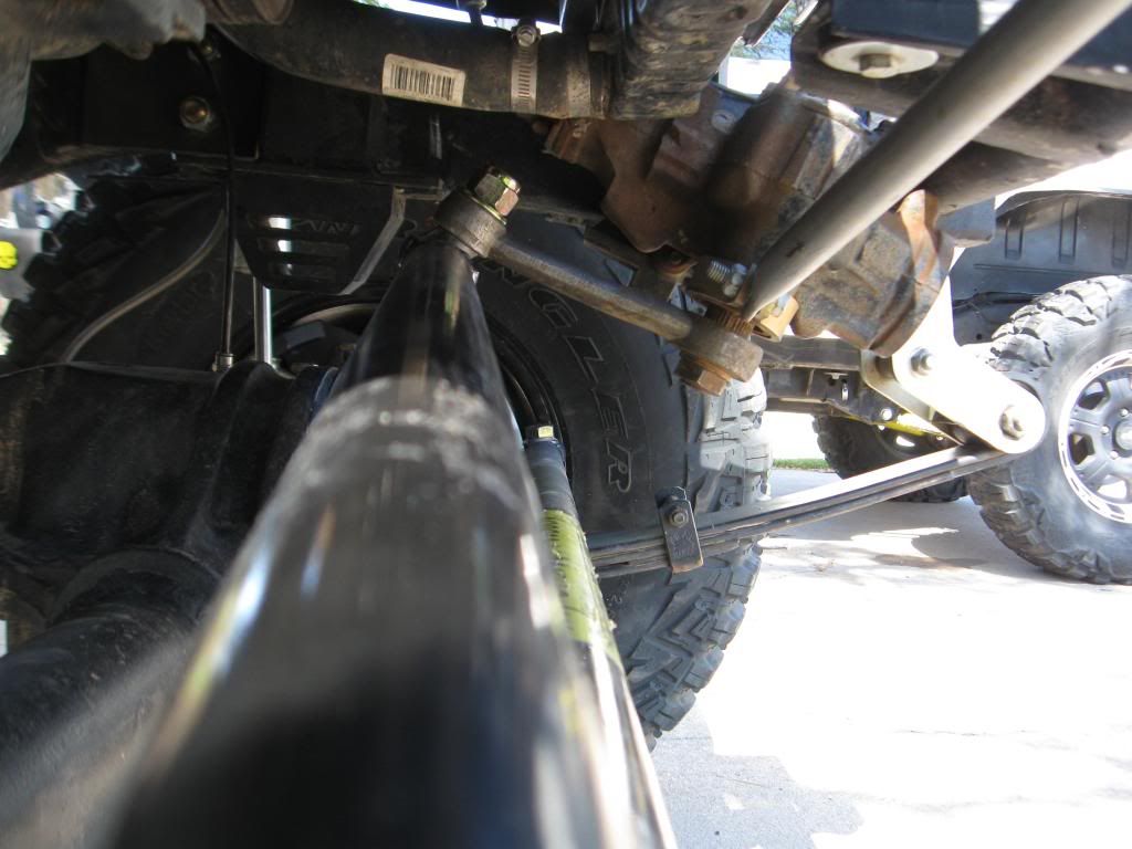

Alright men recently found out I have some death wobble. I have spent some time tightening everything up shackles are good and tight making sure I have no play at any joints. I originally thought my shackles were swing side to side causing it but found this not to be true from the video. I also moved my drag link to a better angle thinking that was the cause of my problems. But that was not the case. So I just wanted to post my little video up here for yall to look at and give me some input. I have my suspicions on what is causing it but wanted to hear from everyone first.

Whats your caster angle set at. Might be too +, also having your draglink above your tie rod connecting at that spot would not help for sure. If you connect the draglink to the tie rod it needs to be in the same plane as the tie rod. So basically move it closer to the knuckle and put it in line with the tie rod(behind it). Or connect it to the same point above the tie rod link right at the knuckle.(high steer knuckle style.
My guess is the tie rod/ draglink connection point.

Your steering linkage rod looks awfully close to your spring pack,possibly due to the boomerang shackles,but I think it would be more helpful to mount the camera in front though.I thought I heard some metal to metal contact during flex but I could be wrong.I watched it three times but it comes on so fast it's hard to catch what happened.Do you run a steering damper for larger than stock tires? rubber mass in large tires is not symmetrical around the whole tire. The larger the tire the more it becomes a factor thus the reason for balancing ALL wheels. I'm assuming you've already found the culprit. Care to share your findings or is this a test?

The tie rod/drag link connection worried me a little as well. Mainly because it has a bit of rotational play due to the nature of the rod ends on my knuckles. I will add that this problem seems to have been made worse when I replaced my tie rod heims. My old ones I ground flat so this rotational play would be removed. Only problem with this is that they were binding up when turning due to the knuckle paths not being symmetrical. (my friend had just sheared his heim for this exact reason) I can and will put the old ones on and see if this fixes the issue. If it does the drag link will be moved on top of the knuckle.

It was the heim joints on the tie rod. The ones I didn't grind flat. Once I put the old ones on that were grinded flat my problem seemed to go away. The rotational movement as small as it was (1/16 of a turn) was causing some type of oscillation giving me the death wobble. Looks like I'll be building a new steering linkage. One where the draglink goes all of the way to the knuckle. AND upgrading to 1 3/4" tubing.
