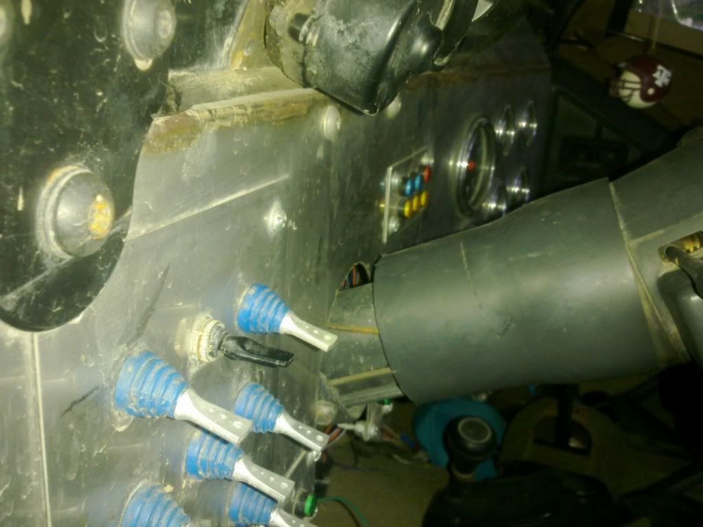

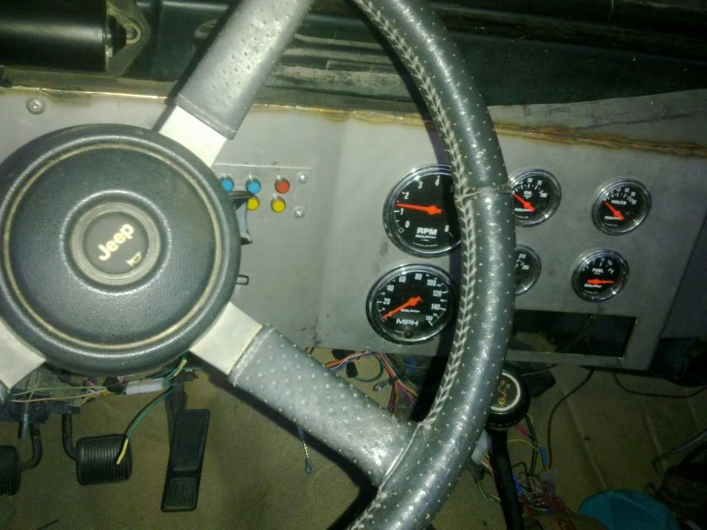

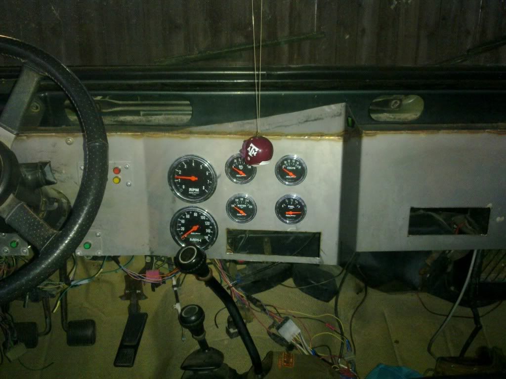

I built a custom dash for a YJ out of stainless during my senior year in high school.
photos were taken with dash not quite finished

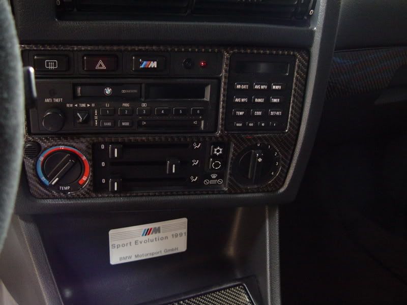

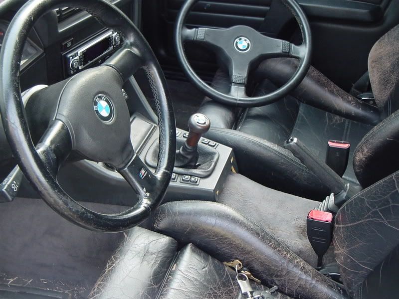

have you thought of angling the hvac panel and everything on the center console towards the driver, like bmw has done since the 70s?
this is from an 91 bmw m3, american. see how everything is pointed towards the driver.
this is hte german base model 316 hvac panel i put in my american spec 325i. everything is still pointed towards the driver and you can change out exactly where you want your stuff to sit by pushing out the panels.
another shot showing the angle it points

if you look at the pics i posted, the dash i built has this angle you speak of
