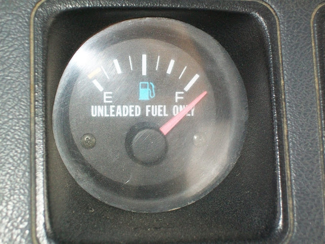

Oh and here's a pic of my fuel gauge. If I park facing the other way on the street, with the Jeep leaning the other way, it goes even further than that.

Originally Posted by Sparrows
Is there a way to just adjust the sweep of the needle? Or does the whole gauge need replacing? Maybe the sending unit?
It's poly. Just checked. While digging around I found this
A little google-fu later and I answered my own question. Found a link to a JF thread (gasp! that never happens lol) and it said that is the part number for the 19 gallon tank.
Glad I figured that out. I think I need to mount my gas can and fill it up so I can run this tank totally dry (at least till it starts cutting out) just so I know how low my needle currently goes.
Thanks
I love JF
Cheers
Well now that you know it's the big tank it's not for sure your gauge is bad....run her dry and see what happens.
When you fill it....it stays above full longer than normal....they didn't adjust the gauge for the larger tank.
I have larger tank too and it's above full when I fill it....not that much though

I was always worried before that I would run out of gas. When it's full the needle camps above full for a really long time, and then after about 5/8 of the tank is gone, the needle bounces all over the place...it will often jump from the 3/8 mark, to almost full, to the empty line depending on which direction I'm turning.
I've owned a couple older cars (70 Nova, 74 Camaro) that had the older style fuel sending/feeler units that get pretty inaccurate when the fuel sloshes around, but on my YJ I though it only had the 15 gallon tank so it added to the confusion.
The more you know!...
Is there a way to adjust the fuel gauge? Or is it something that must be replaced?

I haven't found away to adjust the gauge. By what your saying with the gauge bouncing all over it probably is the gauge....I haven't heard issues like that coming from sending unit. However...if you have a bad wire between the gauge and SU, it can cause that for sure. The ohm reading will change if the wire is bad which will make it jump around. Checking the wire should be on the list of things to do.

Added to the list. I'll dig into that this coming week. I've got a pretty good sized "general maintenance/troubleshooting" list to try and tackle this week before all my goodies start showing up in the mail and the real work begins.
