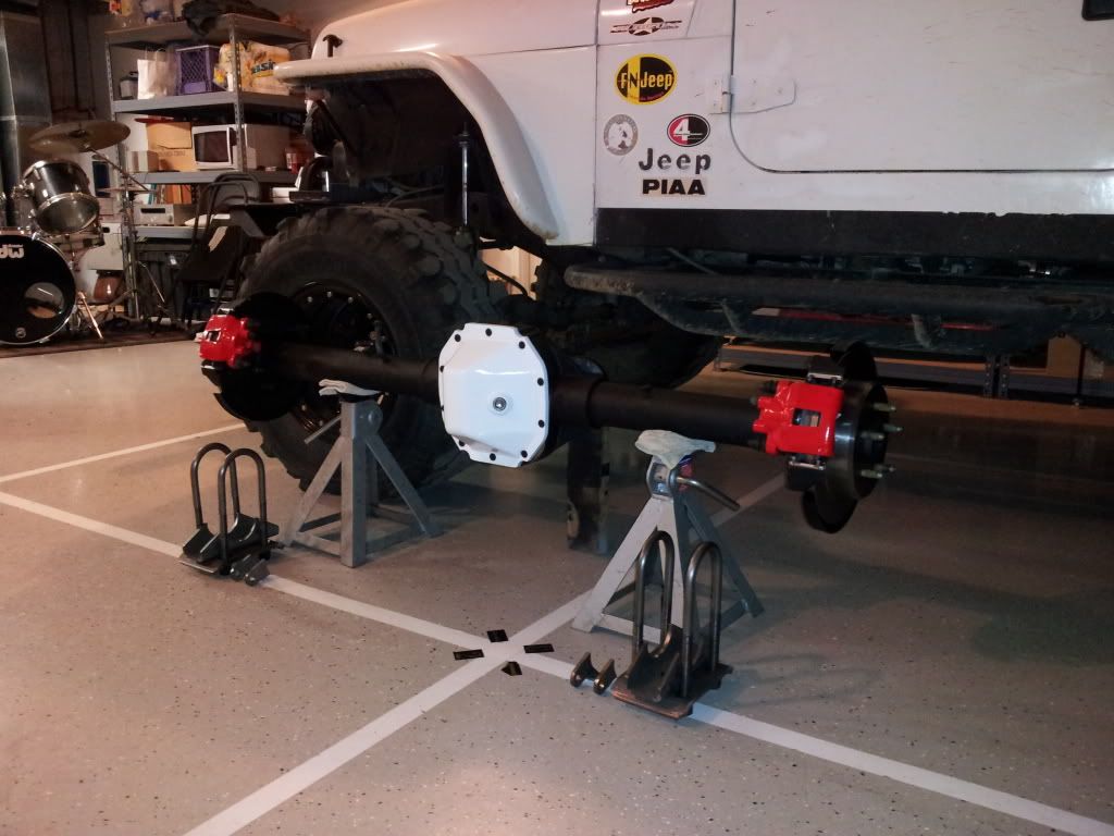

Wow what did you do use glazing putty on the rough cast steel surface?

Not at all - just cleaned and painted it. No grinding or filling was done on the rough cast areas

I jumped ahead and did some driveshaft work, which is detailed in Part 7:
http://www.jeepforum.com/forum/f12/y.../#post15820710
It's not 100% done yet (still needs to be shortened), but it's at a good stopping point.

Unfortunately, I really haven't had time to work on the Jeep much for the last month. But I was able to make a little progress this past weekend. It was added to Post #4 in my thread:
Tummy Tuck Progress 10-14-2013
It'll probably be another couple of weeks before I can make any significant progress.

I finally made some noticeable progress - the crossmember is completely installed:
Full details in Part 4: Part 4 - Tummy Tuck

MORE Upper shock mounts installed:
Part 4 Finished!
Installed and tacked in the 8.8:
Part 5 Started!
