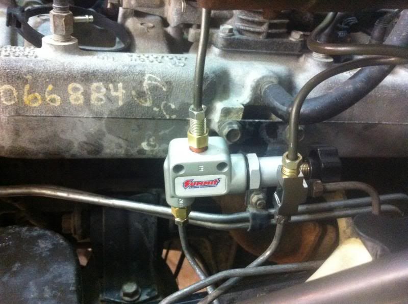

Here is the update. I decided to go with the adjustable rear proportioning valve and T off the front. So far so good, I took the jeep up tp Rousche Creek for a weekend with my club and felt a lot more compfortable. I think in the long run I could use a little extra power from a dual diaphram booster will help but being able to stop facing down a very steep grade in 4x4 low without my foot mashed to the floor gives me a lot more confidence.
