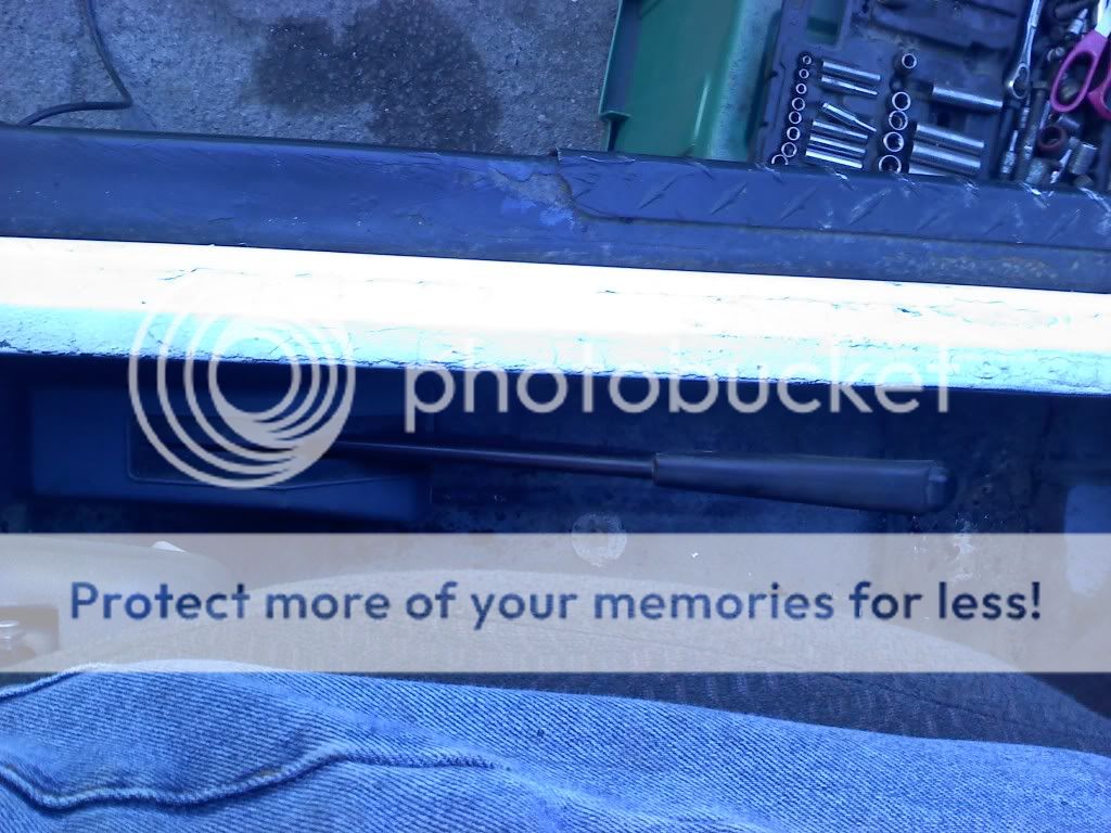

I have a full cage in the Yj and it was a pain to bend my leg to the side to push down the e brake

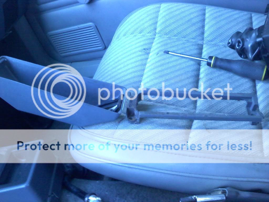

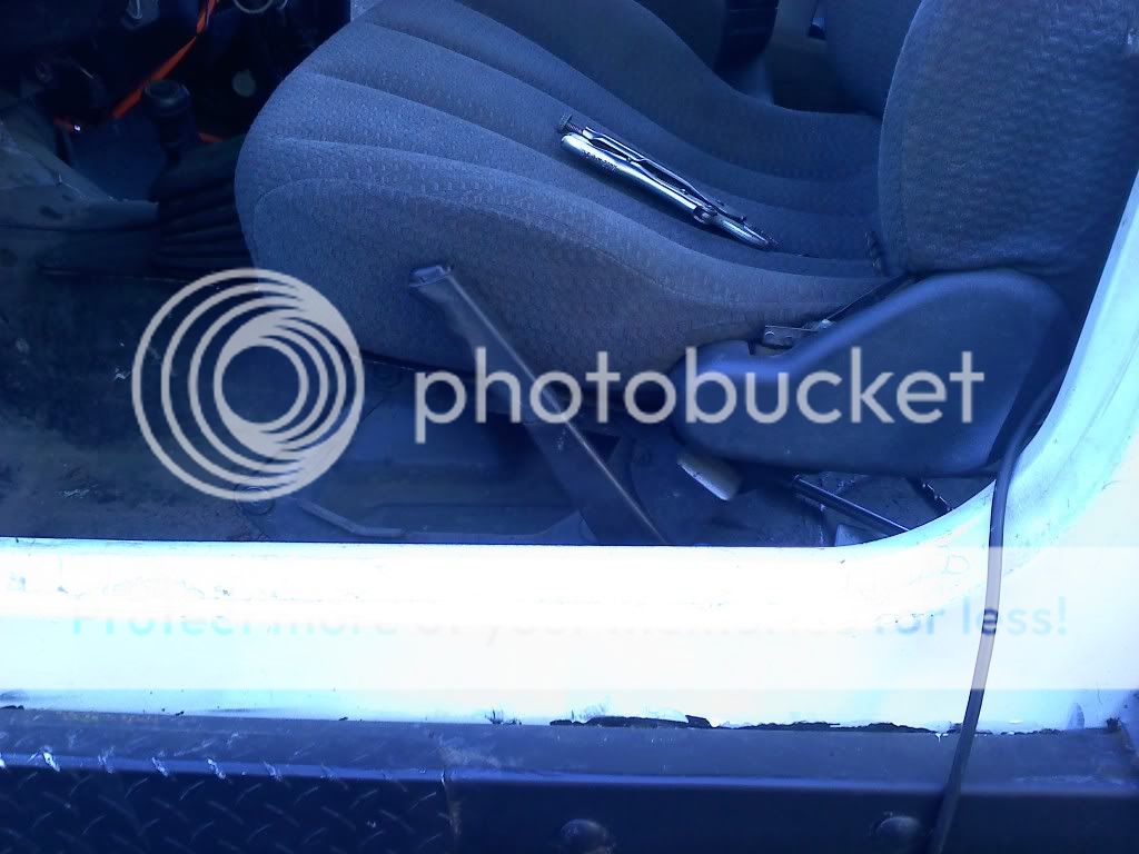

Looking at the XJ in the driveway that Im parting I saw the rip stick style brake in there and thought that its just what I Need
Still in the XJ

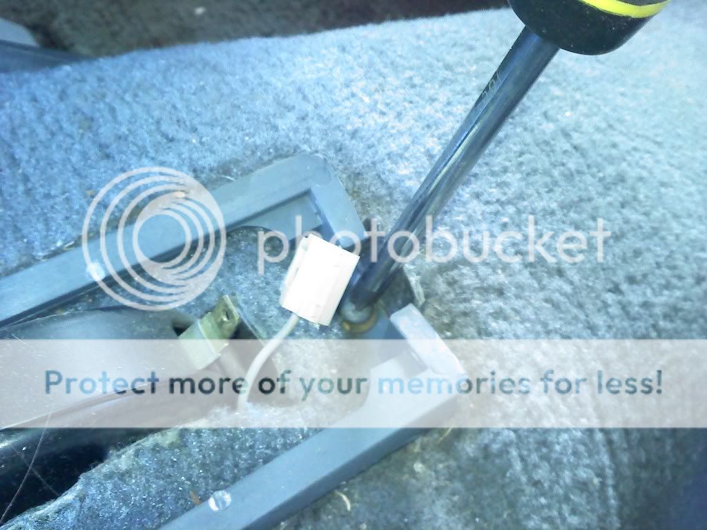

Unplug the plug and remove the 3 screws holding on the trim
Set it aside

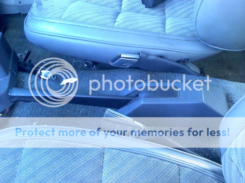

This is what you have now

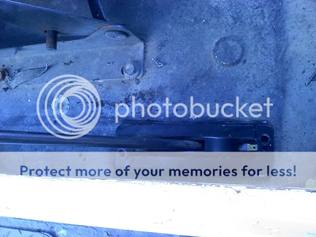

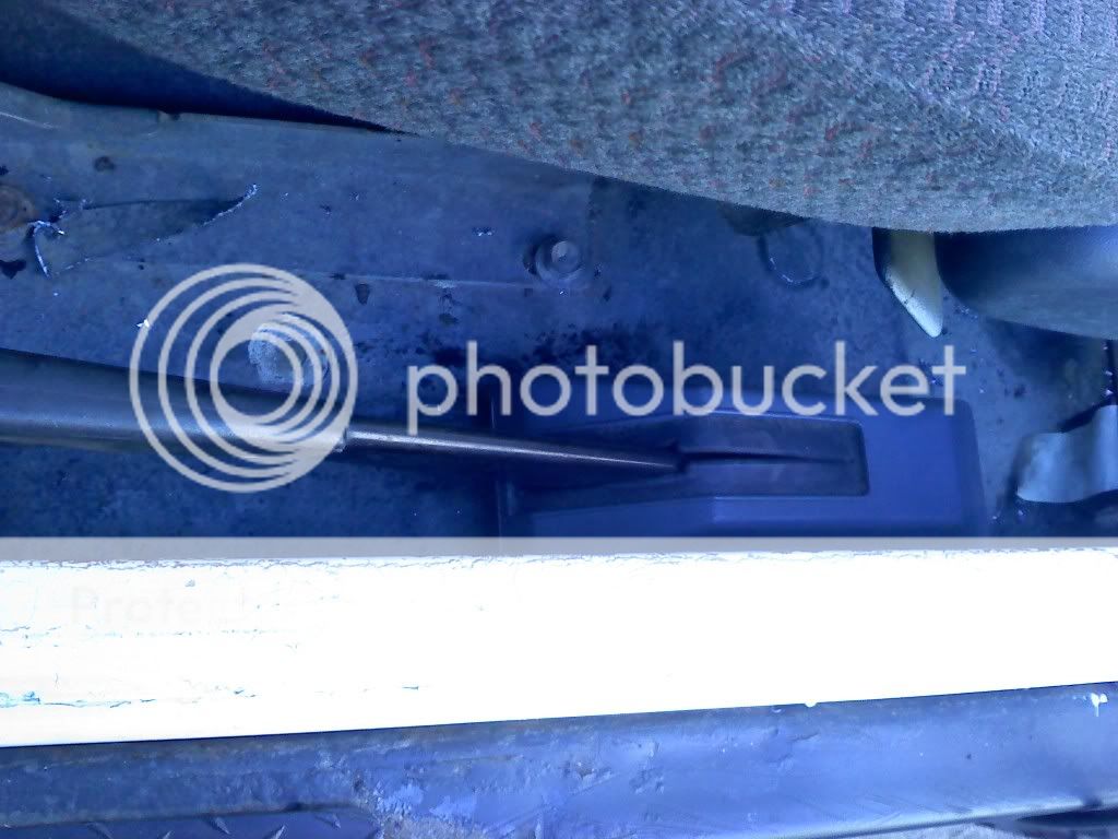

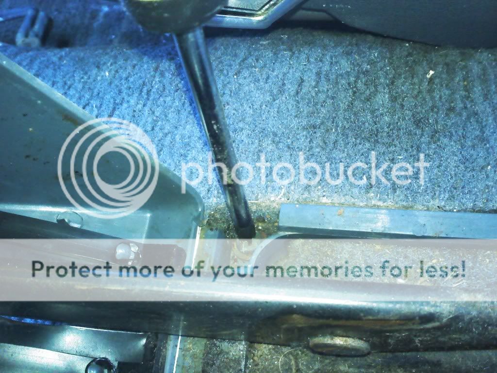

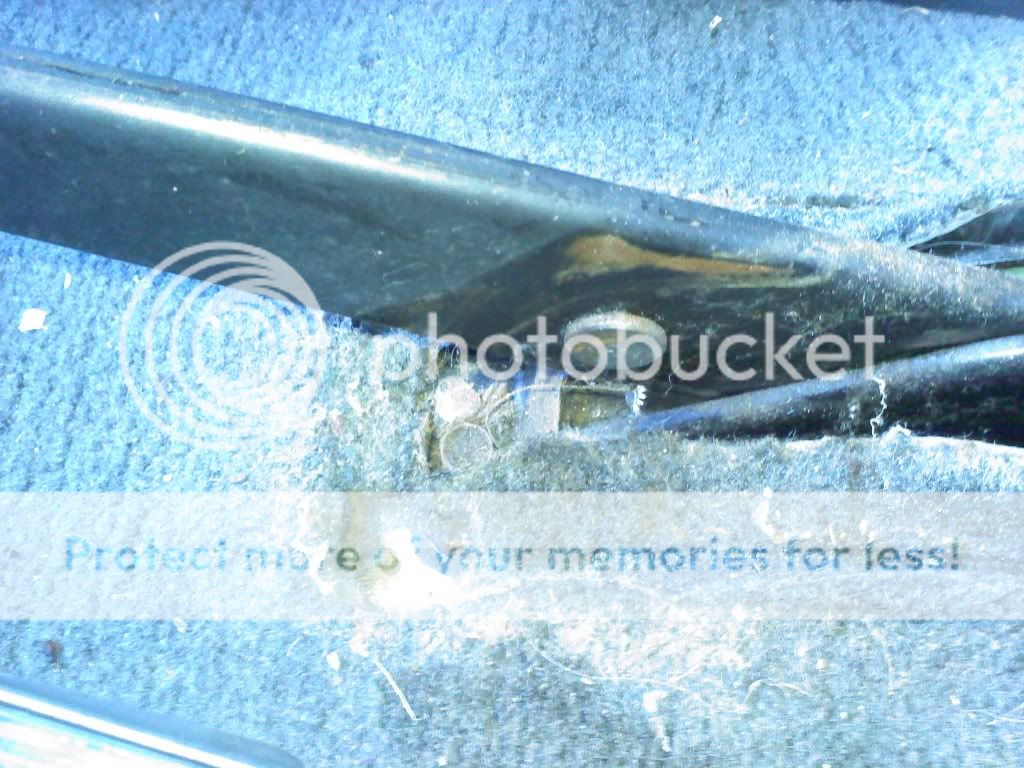

Pull back the carpet to expose the mounting bolts

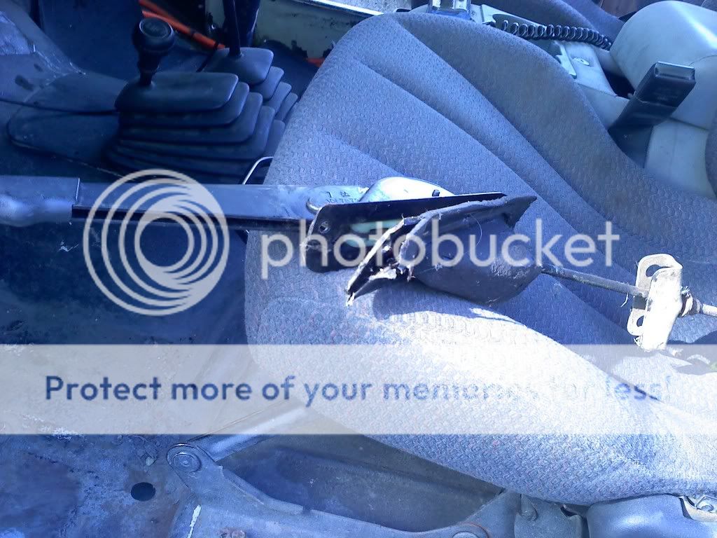

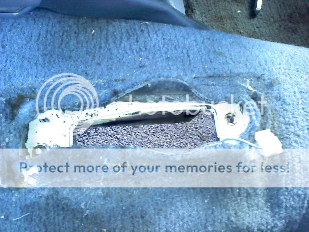

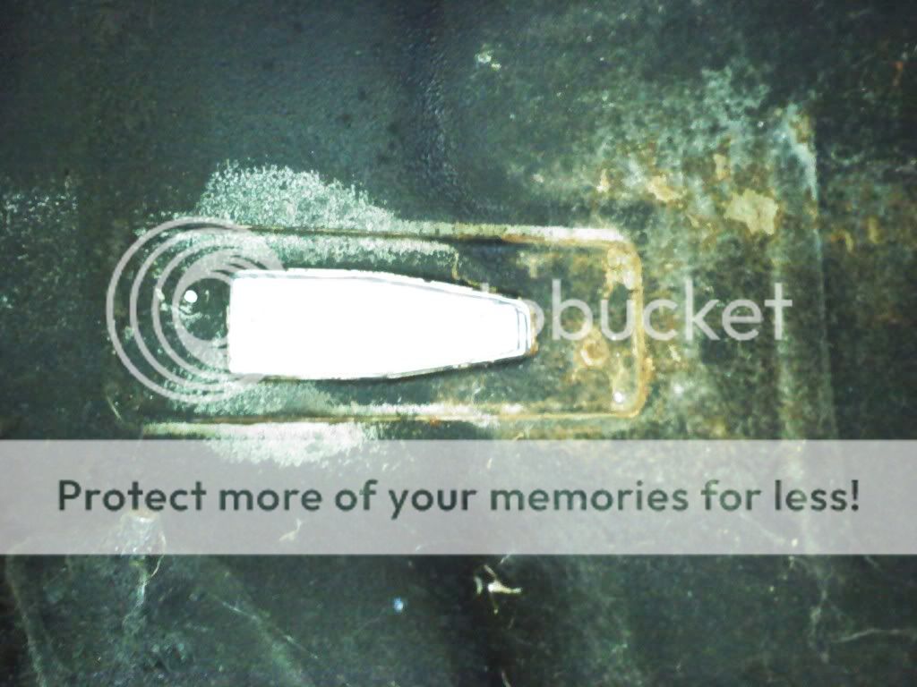

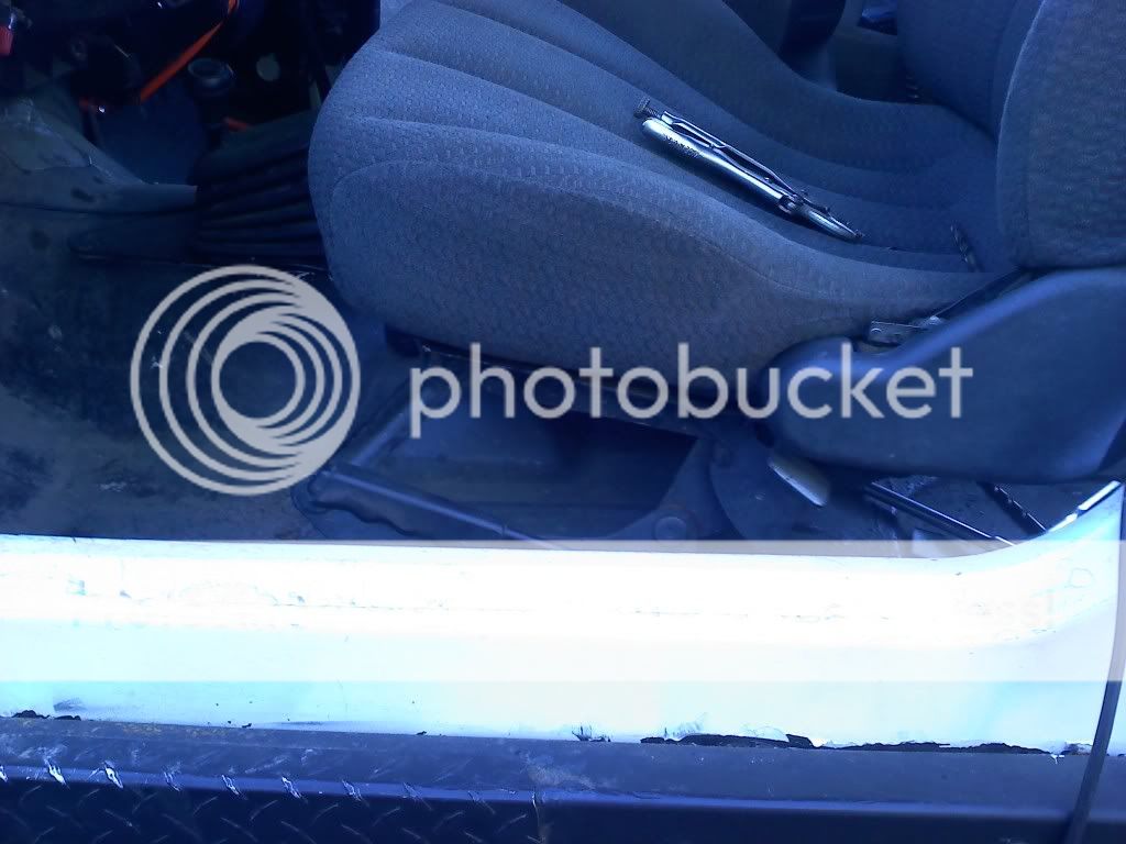

Empty spaces
The works
Card board on top to make templet from the bottom
Sheet metal cut and brake test fit
Bolted in
Cover on
Pulled up
Down
The underside
I did this in less then an hour. I still have to make cable stop brackets and run the cables

Me too. I originally was going to put the rip stick in the center between the seats but cables would be a bit to close to the danger zone of the rear driveshaft
