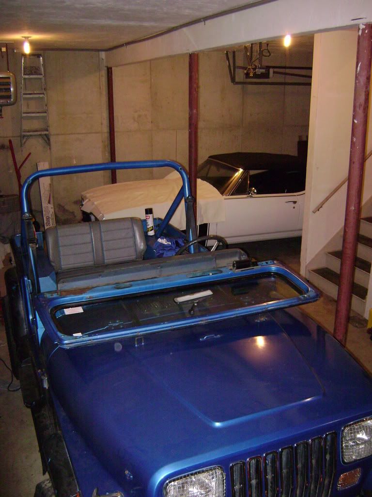

Took the windshield bars off (yes thats a '68 442 in the back ground)

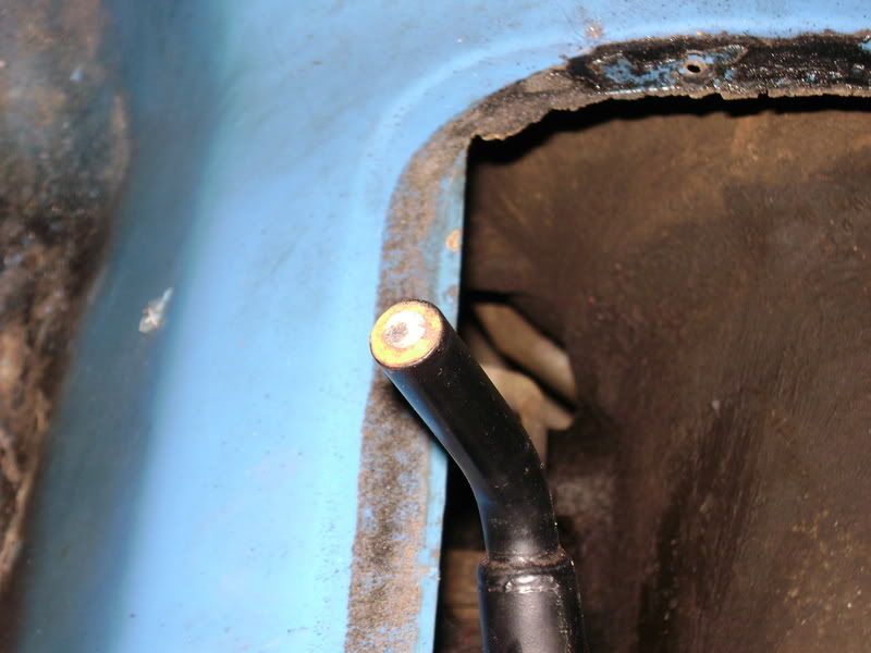

Also got the shifter cover-thing off
has this ever happened to anyone?
Yep, weld an appropriately threaded bolt on there, get an aftermarket shifter knob, and call it customizing.

you had it A LOT worse than I do. Luckily the person before me replaced the drivers side floor. The biggest setback to date is the roll bar torx will not budge. Ive been PB blasting them since i got the heep
Edit: I talked to my father who, as a previous cj5 owner, seems to be convinced that the windshield frame can be patched. I just need the jeep to last through college (5 or so years) any opinions?

My windshield frame rusted in the exact same spot, although i dont think it was quite as bad as that but I decided to patch it... It all depends on how close to the glass it is, if you think you can weld there and not hurt the glass you should be able to do it, just throw some steel and carpet or w/e on the windshield to stop the sparks. You could also rivet on a new piece and just load it up with bondo but that won't be quite as strong as welding. I'll see if i can find a picture of my repair.
