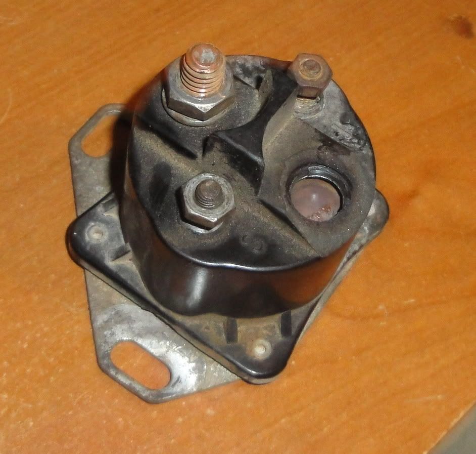

Okay, I was tracing wires and ended up having to fix one that was almost entirely cut through. Nothing changed so I decided to try cleaning anywhere they made contact. I began to loosen one of nuts on whatever this thing is and the whole thing broke off. What is this and could it be my starter problem?

Starter relay. Take it to the parts store. It looks like you found your problem!

Hooked the new one up and she fired right up! Thanks for the help Que!
