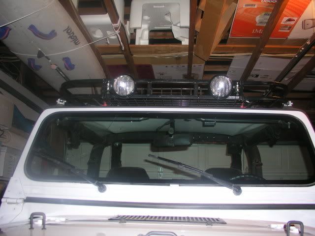

I always wondered this too, mine stops like a foot away from the edge of the windshield, and the passenger one stops before it hits the curve from the drivers one.

This is where your wipers should normally sit. If they are lower than that, someone "adjusted" them down too far. It looks better when you aren't using them, but doesn't do the job when you need them.

Yeah I'm not too concerned with how they sit in the off position, as long as I can see when i need them, thats all i care about. thanks The_Goob for posting a picture, thats exactly what happens with mine
