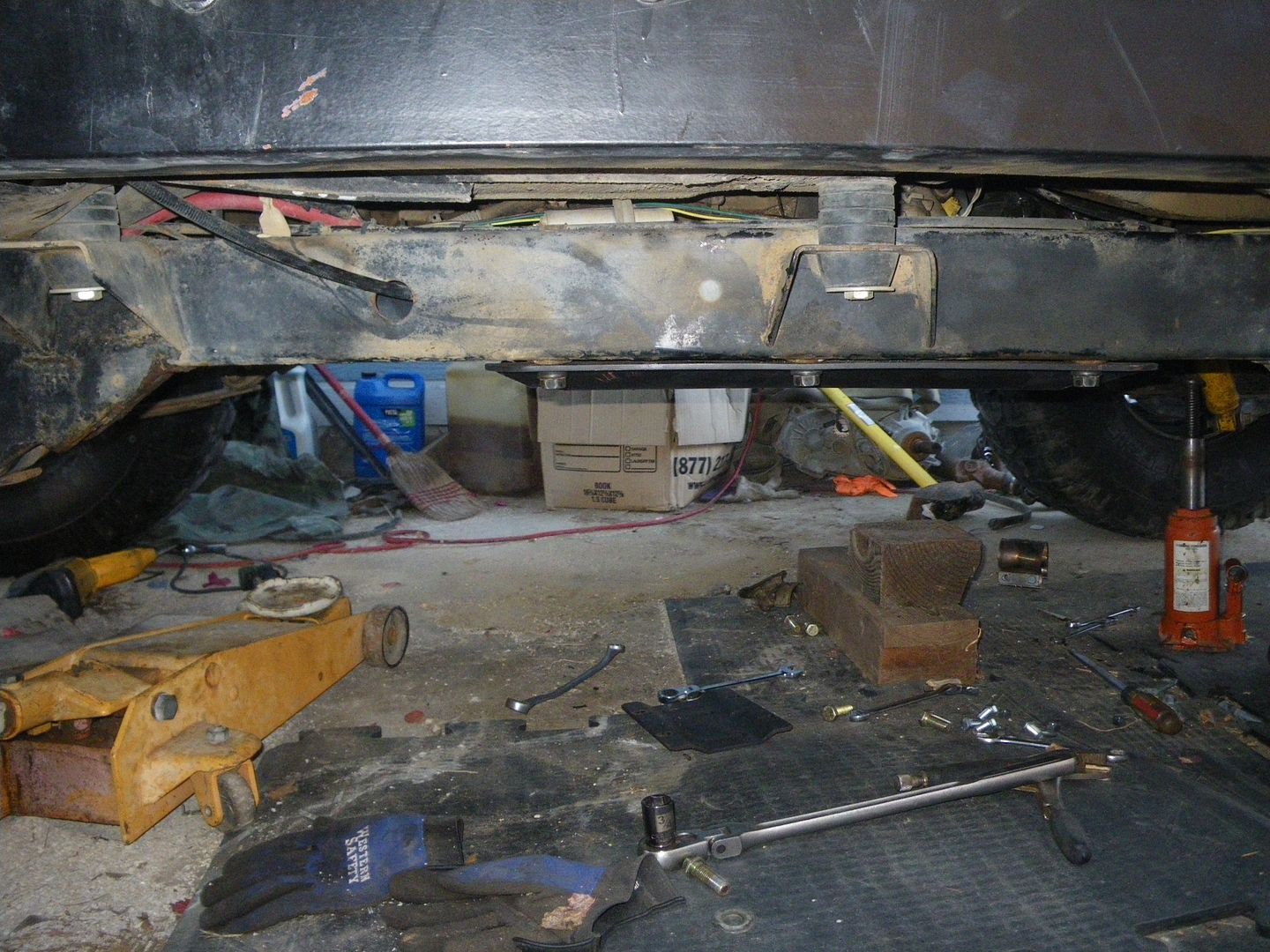

I have the ultra thin one form Undercover Fab and like it a lot.
They say you need a 2" body lift for it to fit but I was able to make mine work with a 1" BL and a few hammer smacks.

I was able to re fabricate my trans mount with a little cutting and welding to gain another inch. I have an auto trans, so I'm not sure how it would work otherwise.
When I put mine on I took off the whole exhust, then towed the jeep to a custom shop to have the header, down pipe and all the rest relocated to fit up in the new skid. Turned out great.
