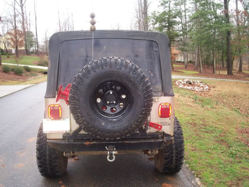

It is not on the front but you get the idea, as far as theft, they would have to take my spare off and they need a two different wheel locks to get that off.

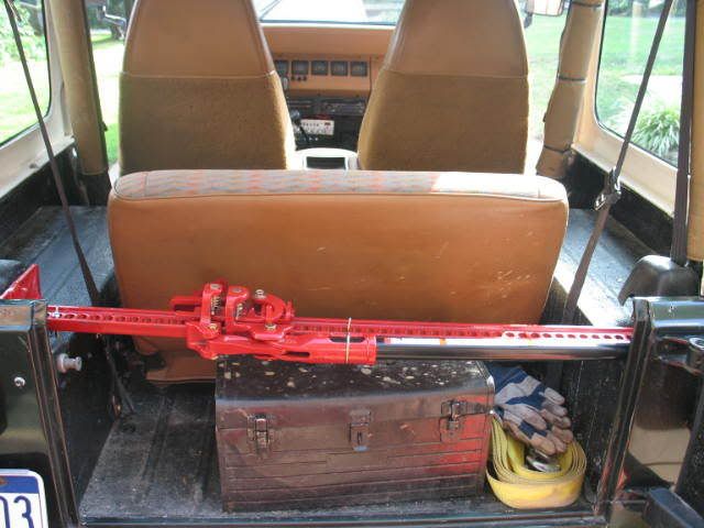

i made mine out of a couple of peices of angle, a couple of bolts and wash, and then used lug nuts to hold it on. that way i always have a couple of spares if needed.
then i mounted it behind the rear seat to save space as i have a winch on the front.

Posts: 56
location behind the seat
b00g is offline

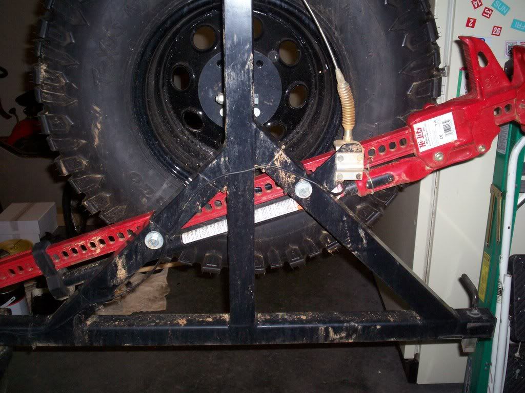

on the rear tire carrier
go some easy unscrew knobs from ACE and i figured that the only time i will need my hi-lift i will usually need my tire as well so having it mounted behind the tire is no big deal.
