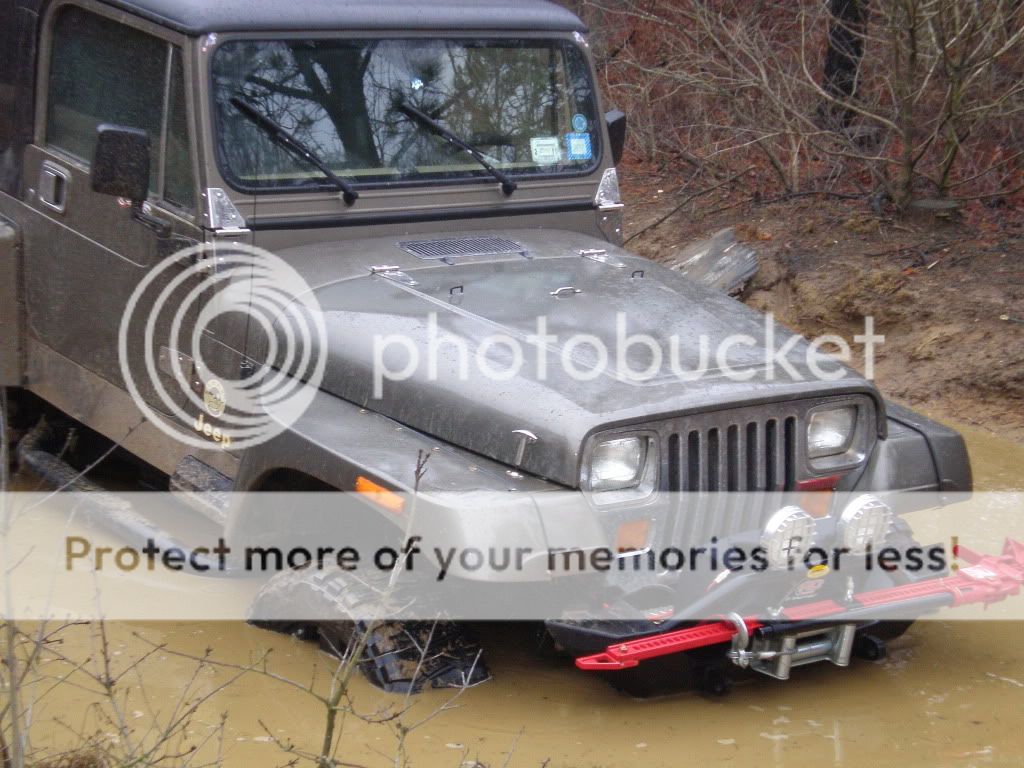

In the 3 time it happened i was only going to the button of the bumper ish. There is the deeper ones. But i rather not have to swim to take a picture. This picture is only partially pulled into the puddle gets about a Foot deeper. Nor is this one the deepest. For the most part the puddles are below the ICM or a tiny bit touching it..

i was thinking about it but kind of lazy to have to cut and resplice the wires or make a very large hole so that i can slide the plug through. Both sound annoying to do. Oh ya this picture was on a day where it did not rain for a long time and before the snorkel
