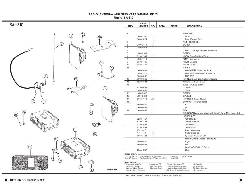

I actually researched this - when I needed a new antenna.
The red Jeep has the boat antenna - but it's mounted in the correct location. The second picture is the correct antenna for our Jeeps - but it's mounted in the wrong spot.
The base should be that triangular shaped one, three screws and a rubber gasket between the body and the base:
Some also has a plastic stabilizer mounted a few inches above it that the antenna goes through. This is where the 'two piece' comes from. It keeps it from slapping against the body. This wasn't original.

Per the OEM parts catalog:
