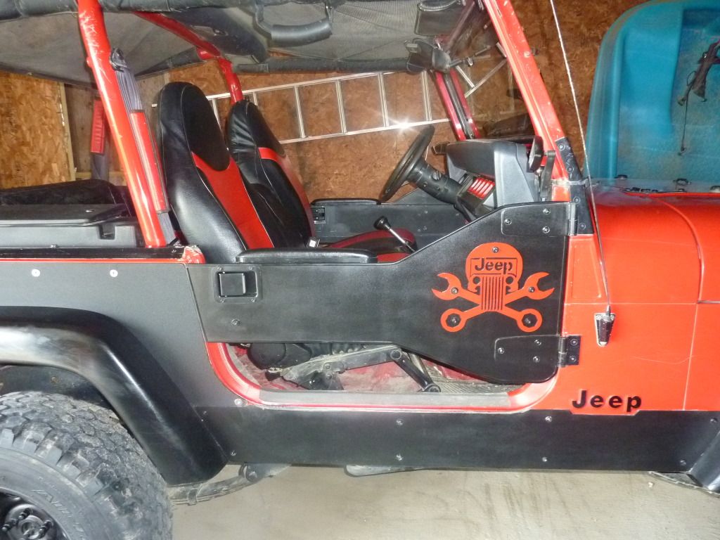

My favorite is my homemade doors.
I also have Ford ranger 60/40 seats.
And led rear lights.
