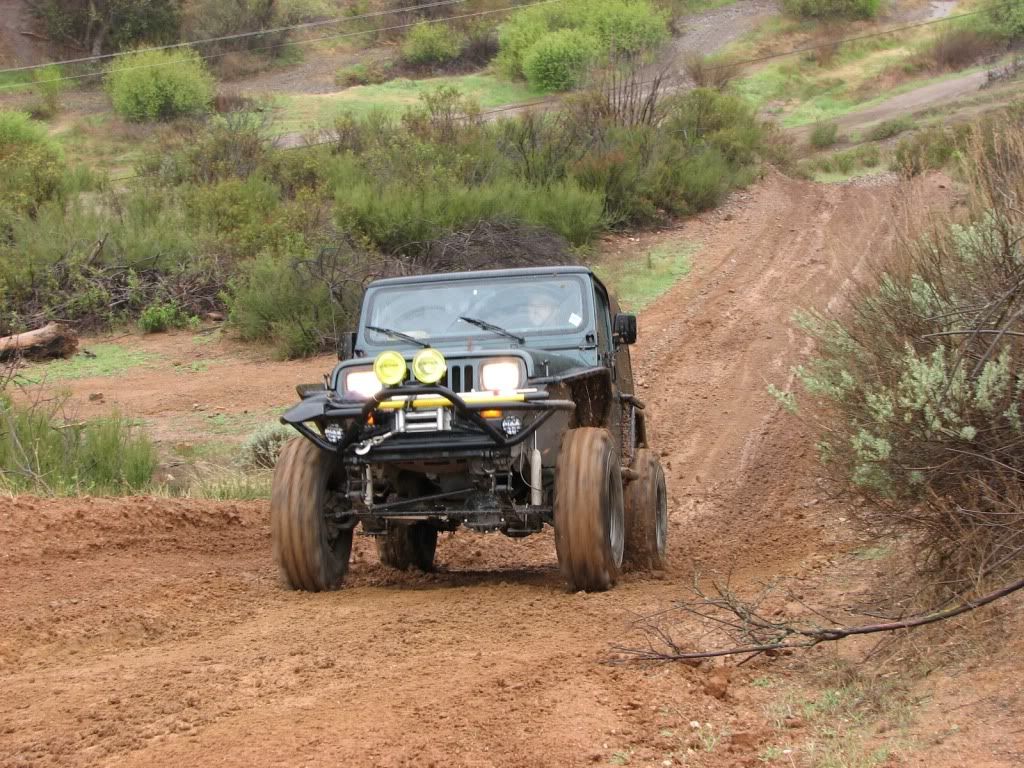

Sometimes you need some meat to get up a hill. I was the only one that made it up this one on the first try.
The hill behind is actually slightly downhill not uphill...

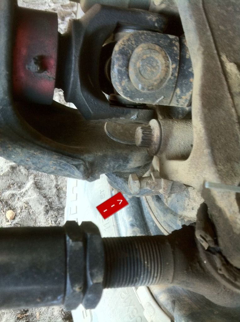

The d windows I am running in the pic above don't allow the tires to rub the springs at full lock and I have the stock adjustments on the steering stops. If you end up rubbing, put a washer behind this:
