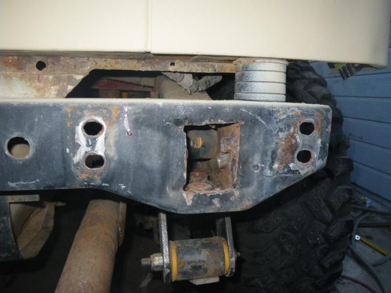

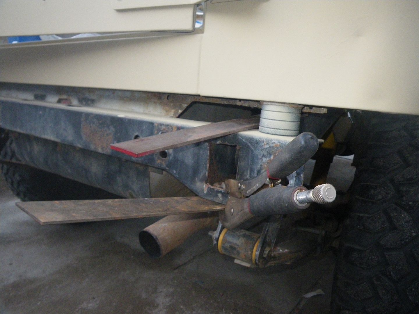

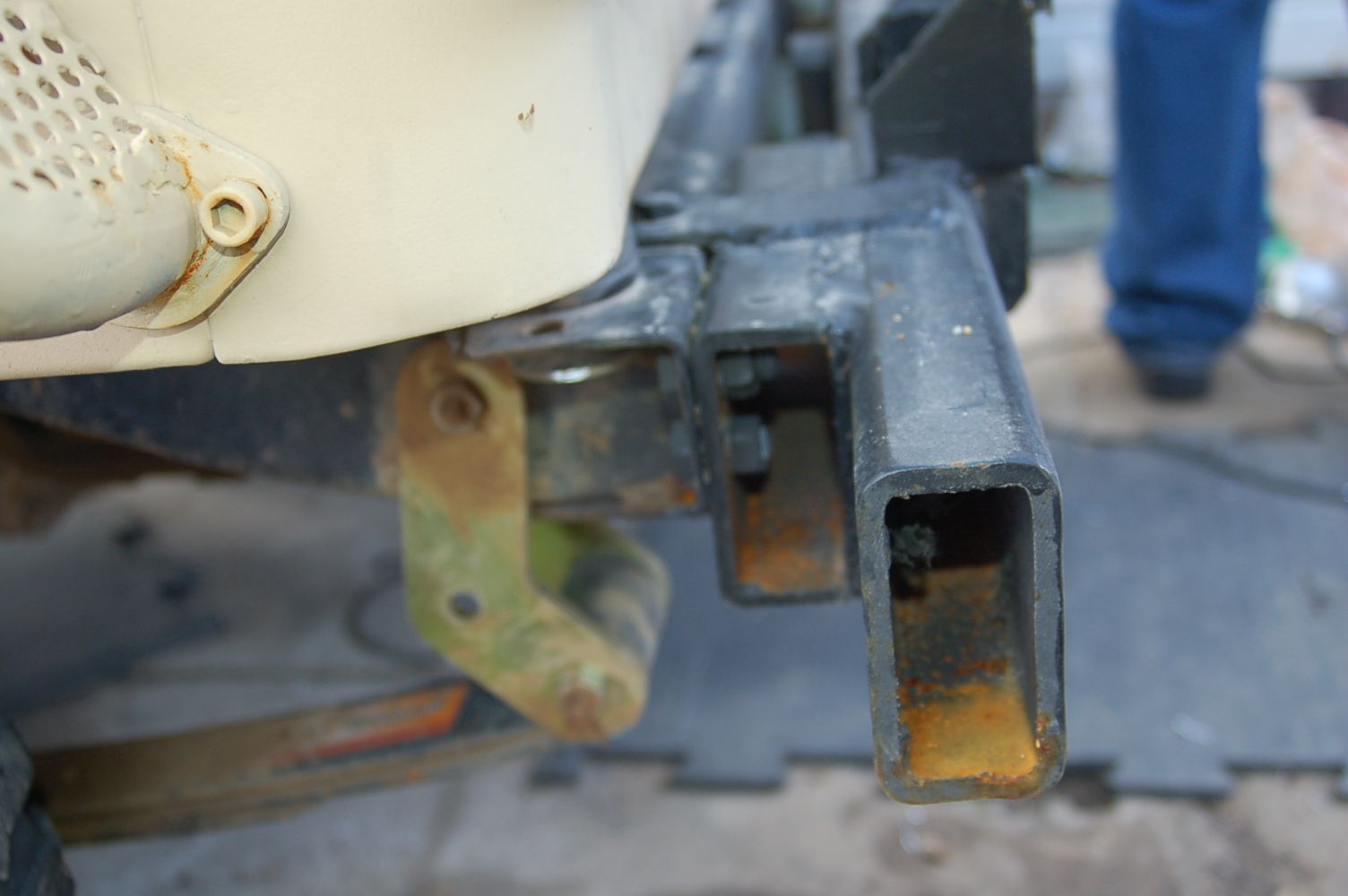

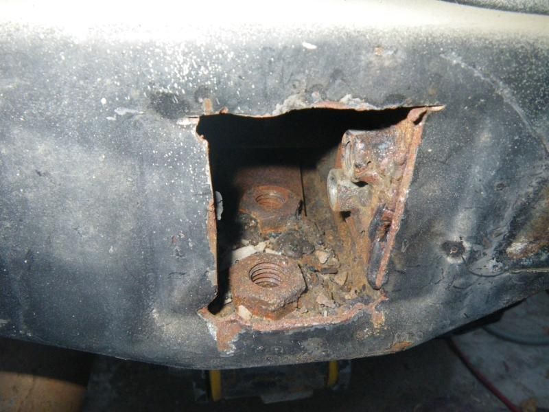

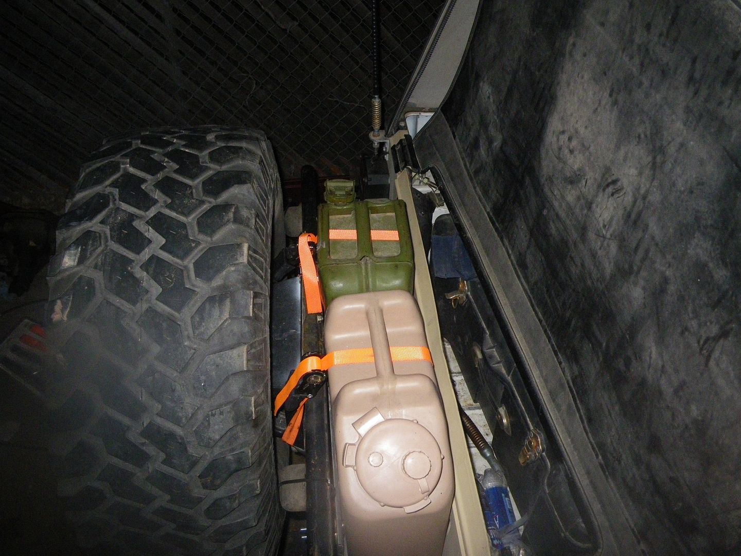

Here's mine, very, very strong.
bolts and tabs top and bottom of the frame.
I offset the bumper so my gas cans would fit.
