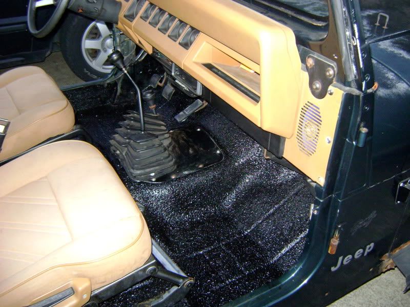

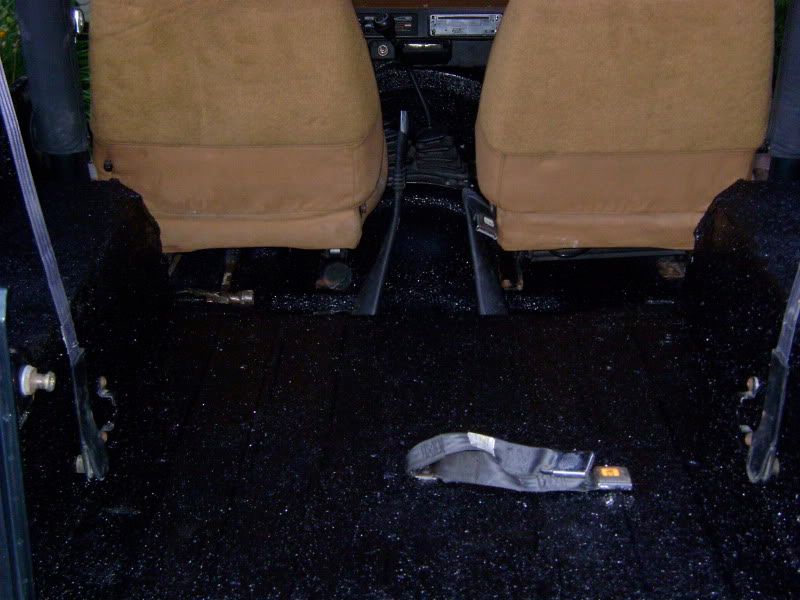

This is the only pic I have that really shows anything and it's not much. This is after 6 years, and it's topless from March to October. For the first 2 years it was my daily driver and it rarely had more than a bikini top on it all summer, so it's been rained on quite a bit. I used the Herculiner kit you can get a Walmart for around $80, it's faded some but not too bad.

How does the Herculiner deal with heat? Does the floor get crazy hot?

I haven't really noticed much heat from it, I don't have much to compare to though since I tore out the carpet right after I bought it. That tapper handle is one of my "treasures" from my garbageman days You wouldn't believe the stuff people throw out. Where are you at in FL? I just left PCB yesterday, lots of Jeeps down there. Love the weather.

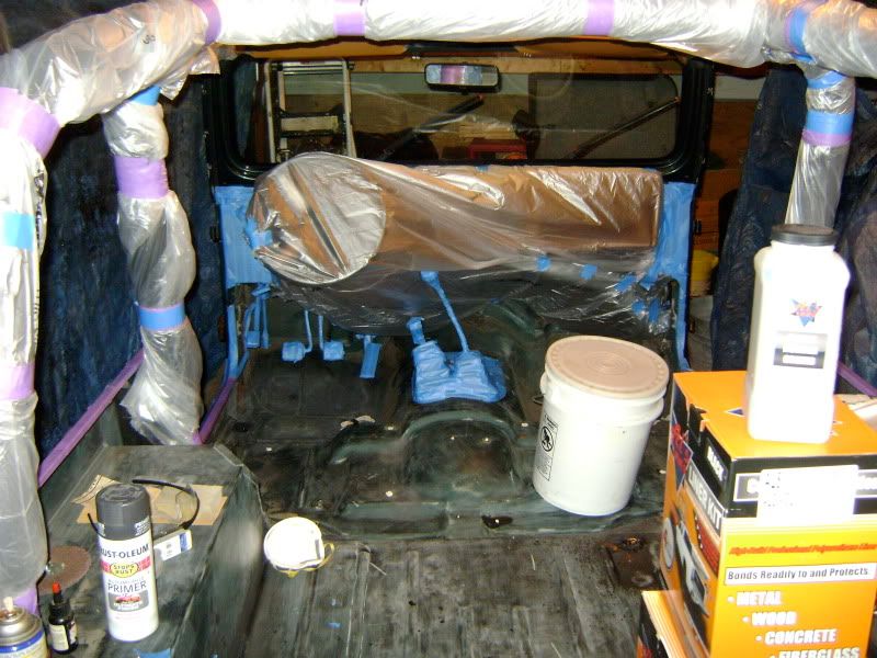

I originally used Al's Bedliner but had a little trouble with the spray gun and the paint hardening up. I finished the job with a can of Herculiner. I do not know if it was bad or not to mix the two, but I wanted it to look right. I did sand the tub for about a week and used Acetone to really clean it
Before:

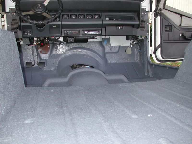

Before I put everything back inside, including the heater box....
