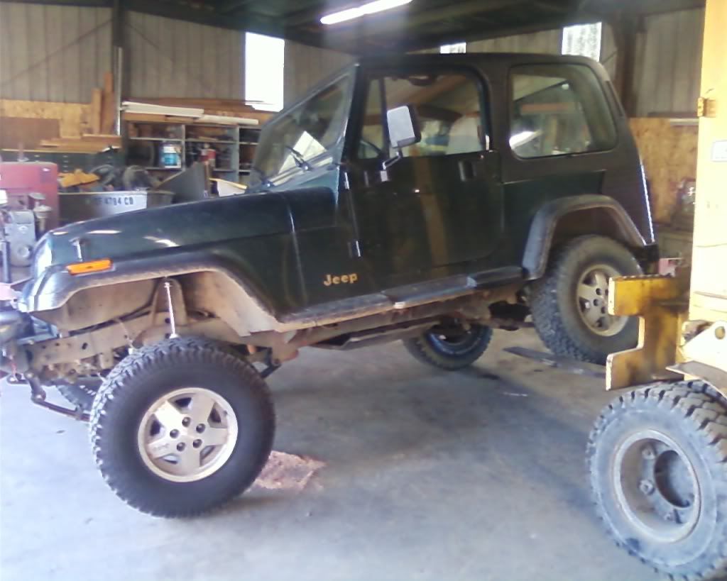

Originally Posted by Jrivv View Post
That is a straight up 4 inch lift? How's the ride on it? I have heard skyjack is not too good.
Well, I had not been in a yj before I got this one, now it rides better than the only other leaf sprung vehicle I've driven. (Dads '84 Chevy k-10). But before I scrapped the trac bars it rode like a horse drawn carrage being pulled by a funny car. I wouldn't recommend the skyjackers though. They are too stiff to flex effectively. I think that it doesn't look silly because of the extended flairs, they are 7 inches across, and I believe they extend down further about an inch lower than stock.
Relicmoto is offline
post #64 of 73 Old 06-10-2013, 05:51 PM
Anticanman
RIP one good jeeper
Anticanman's Avatar
Location: Ripon
Posts: 20,368
Front is rubicon express and the rear is skyjacker.
Which do you think flexes better?
Luck Favours The Prepared
Anticanman is offline

Posts: 53
Is the rear flexing at all? Lol.
Evidently the front... the skyjacker looks like there is little to no flex as someone else also noticed
