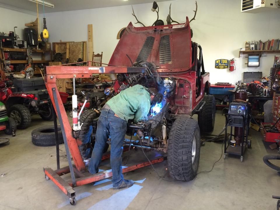

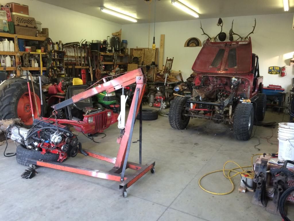

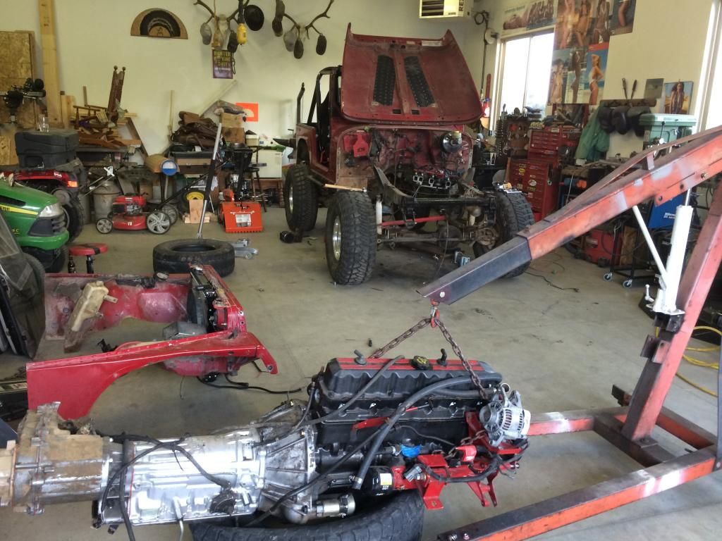

I didn't like where I put the new motor so I pulled it back out and moved my mounts an inch forward.
