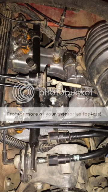

New front fenders and tuned the old Weber
Finally got around to installing the new fender flares that I picked up from Quadratec. I also cleaned and fine tuned that darn Weber.
1451472_623973620986206_821337749_n.jpg   1460247_623973730986195_1767883191_n.jpg   1452468_623973677652867_279928629_n.jpg

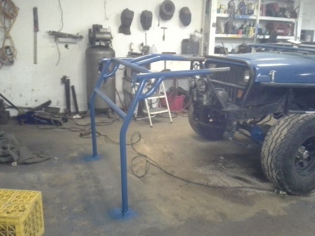

Finished painting the cage and installing odds and ends.

Finish installing the ported intake manifold/4.0 tb/and 19 lbs injectors!
