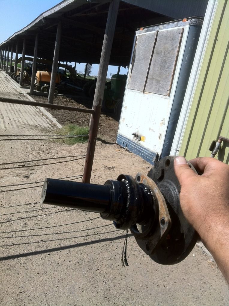

I pulled the differential apart in my Dana 35 3.07 rear axle by finding a relatively easy way to get the spring pin out of the spider gear assembly. Only to learn my axles must be an upgrade, as they don't have a C-clip to hold them in... So, how do these axles stay in while driving down the road? Looks like the bearing retaining plate at the wheel is the what's keeping things together along with a pressed on ring behind the bearing. humm... not real familiar with this configuration.
89' YJ
In 89 they were non c clip. There are 4 bolts on both ends holding them in.

Kinda like this
