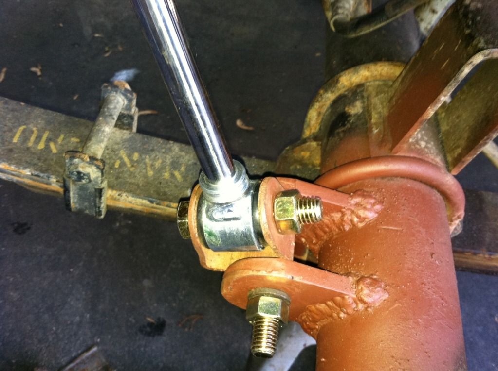

Quick question...I'm installing my teraflex shock bar....Is there any reason that I couldn't just use the normal bottom perches instead of the Teraflex bracket things? I have the top bar bolted in and am about to weld on the shock perches to the axle, and it looks like it will work without having to use the extra teraflex piece bolted into the bottom.
yes or no?
Cheers
I pretty sure you have to use the bottom mounts or a mount that rotates the bottom 90 degrees from stock. Otherwise I'm not sure whether there would be enough room to allow the shock to sit at a diagonal like that without stressing the bolt and bushings.
yes or no?
Cheers
I actually really like the Tera lower mounts. I didn't want to buy them so I jus made my own copy of them. They help keep the shock from binding and allowing it to move some while your suspension cycles. I don't run the Tera shock bar anymore now that I run outboarded Ford shock towers but I still use my lower mounts to allow the shock to move some and not bind.

Its prolly best to use them.
Thanks for the chat and for help sorting that out!
That's what Anti told me. The thing is, I bought the MORE 8.8 shock perches and they are cut at a bevel meaning they cant one way already. Tomorrow I'll snap a pic of why I thought I could get by without them. They angle perfectly to match up with the upper bar and the lower mount looked superfluous...
Seems to be the consensus. Thanks gents!
I got them in and welded on and got everything hooked up. MUCH better than it was. I actually have (gasp!) travel back in my shocks lol.
