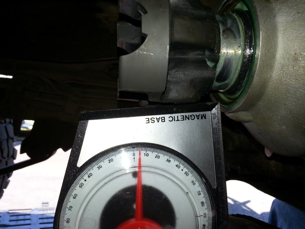

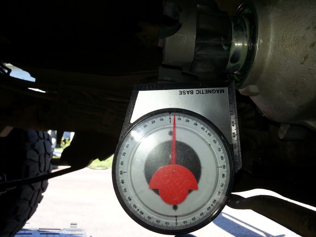

I feel like im doing this wrong
Can anyone tell me if this is the right way to get the angle of the yoke on the sye? And then I just drop the pinion angle 2* right?

I've never used a angle finder when setting my pinion angle. You can just point the yoke right at the SYE output and then knock it down slightly. Honestly it doesn't need to be that precise.
But yes you are doing it right.
