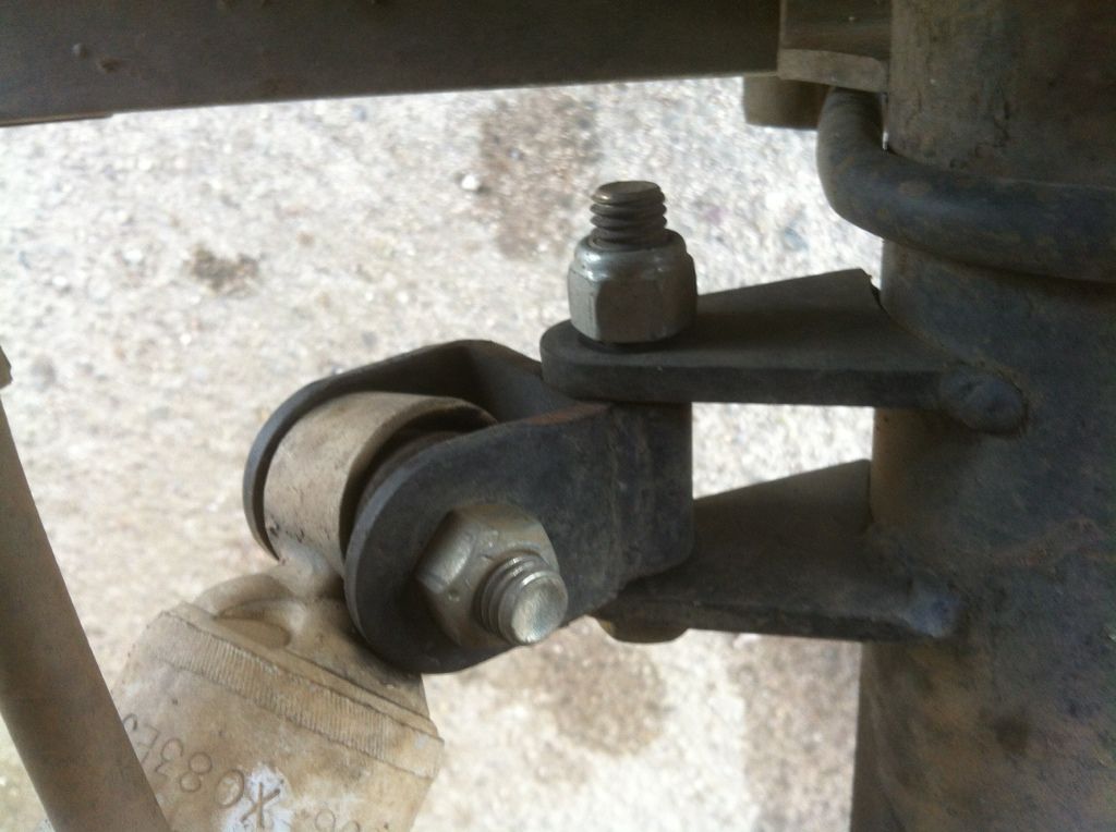

Also if you do get the teraflex bar make sure you get the lower mount section to rotate the lower mount 90 degrees since it will be running it diagonally instead of straight up and down. Or make your own since they wouldn't be hard at all to do yourself. Part number on teraflex mount is 1514700 if you go that route though.

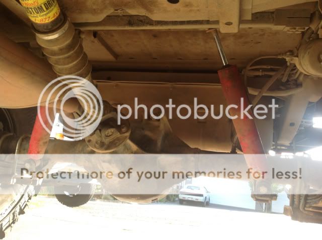

Are you running one of these set ups? If so do you have a pic or two? I'm having a hard time imagining how it looks all put together.

post #45178 of 74715 Old 06-09-2013, 08:00 PM
Ken3783
Location: Sitka
Posts: 341
Cheers
Anti beat me to it but here is my setup as well.
Cheers
Here you go.......
Oops didt see the last two post haha
