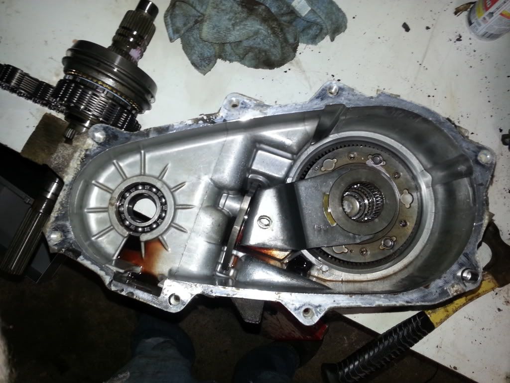

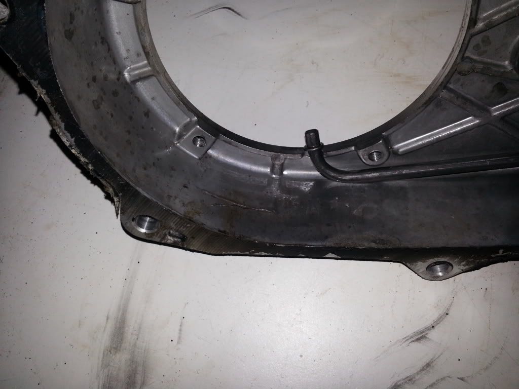

Did anyone else notice these casting marks in their case?
I was looking for marks that may indicate chain slack (found none) But saw these raised casting marks. They normal?

Case looks ok to me...
Yeah, mine had the same catsing marks.
