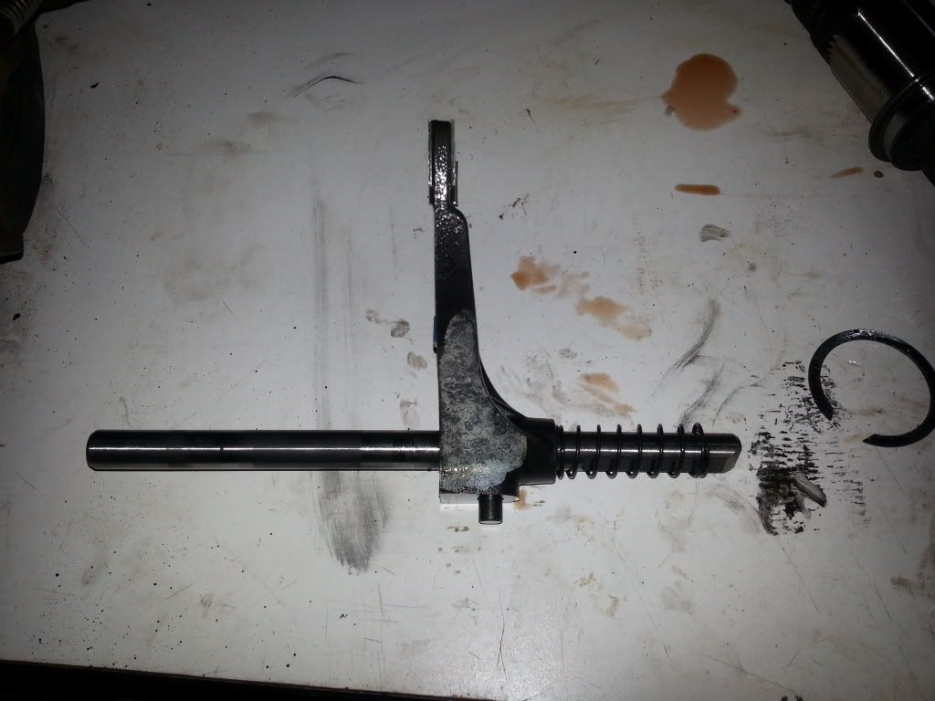

Im in the middle of taking apart the transfer case for a sye and I wanted to check and make sure which side of the mode shaft needs to be cut down
When you install it the correct end will become very obvious to you.
It's the rear end. Assemble it in 4Low and go from there.

Its the end that pops out of the little threaded plug on the new tail housing. Like Rik said, its obvious. An angle grinder makes short work of it.
I figured it was the side with the spring but Im still waiting for my sye to get here and wanted to double check. Thanks!

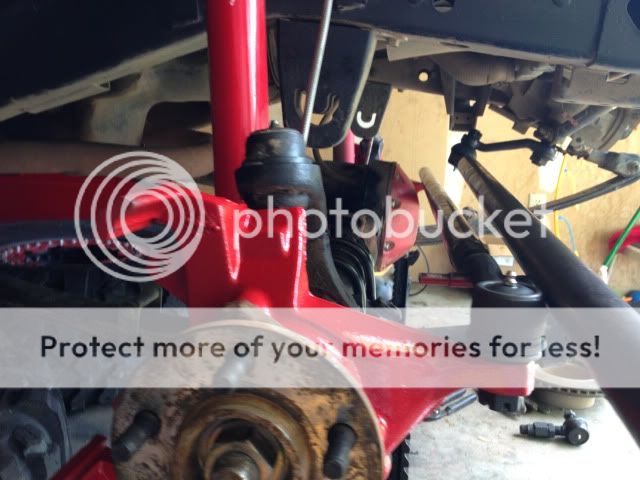

Got my steering knuckles/pitman arm back from the shop and got the painted and installed, than I measured for the Dom tre 40 inches and draglink 22.25 inches. I then reinstalled the rear 8.8 cover and fill it back up with fluid, almost forgot dropped the Dom off to get cut and welded!
And a comparison of the hole for stock tres next to 1ton
zte87 is offline
