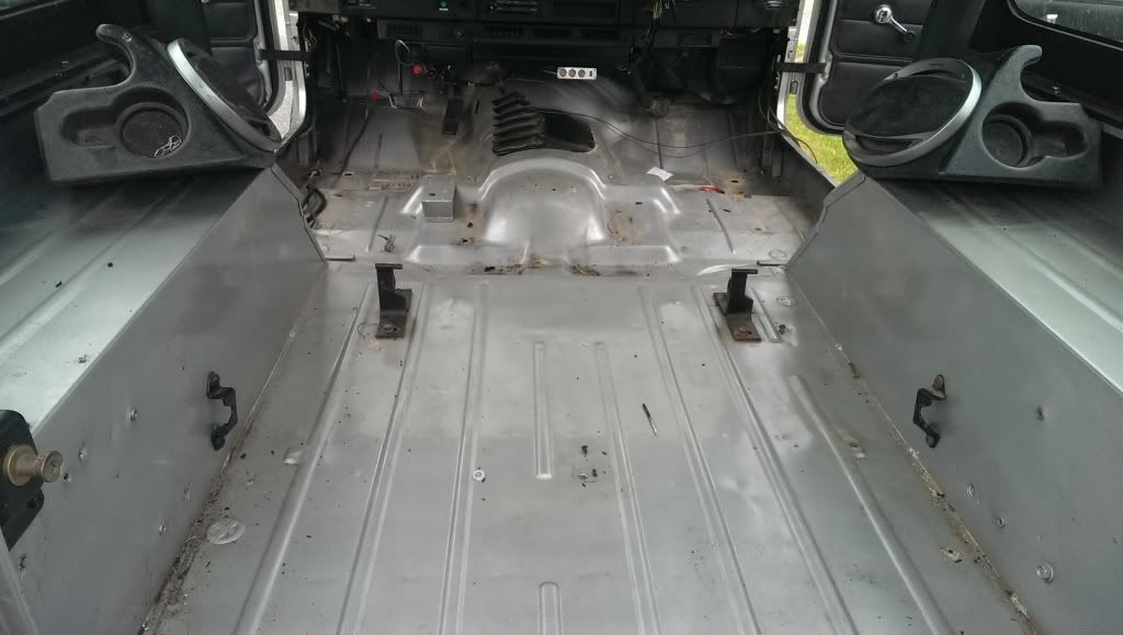

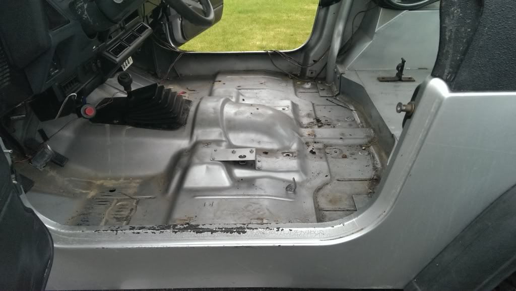

Pulled out the interior to get ready for Raptor lining the tub tomorrow. Still have to scuff up the paint, clean and tape off, but the larger items are out of the way now.
Don't forget to pull your rear seat mounts! Also, I found it a lot easier to pull the shifter boot and panel and line that separately, that way the screws don't get covered and crack the lining once dry and you need to access it. That's a lot of work... but worth every sweat droplet.
