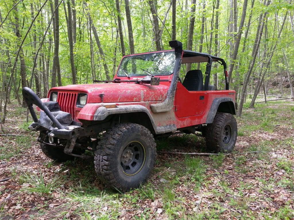

I finally got around to taking the top and full doors off! Kinda had to after swamping it yesterday, made it a lot easier to hose out lol Now I get to use my Jammock!

Took it out on lunch break
Noticed I have a hesitation if I punch the throttle. Drives normal otherwise, maybe even a little peppier. Any ideas?

I think its the elephants trunk that's causing the hesitation.

The elephants trunk has been there for over a year now though and has saved me a few times already, so its not going anywhere lol besides, I noticed no difference in power, good or bad, after installing the snorkel.
