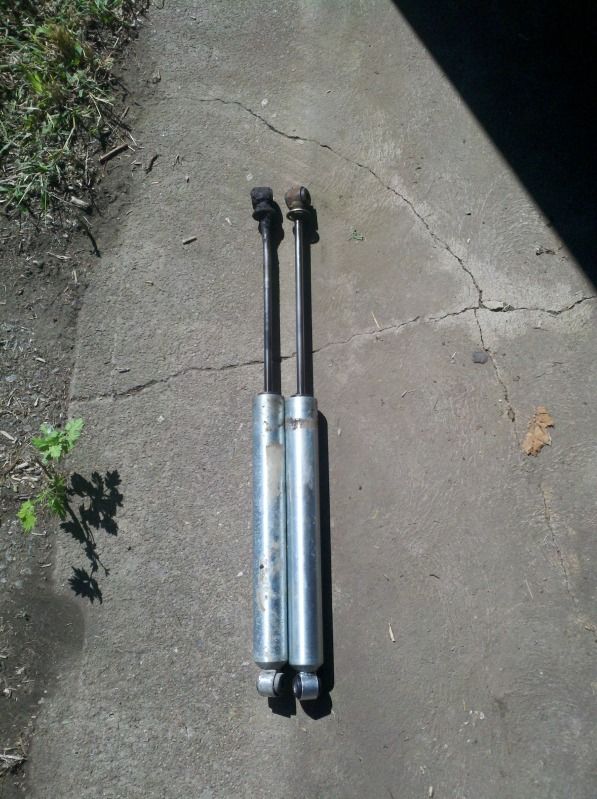

started to try and figure out why I have no travel in the front end. Bent shock shaft might have something to do with it. Bent limiting me to 2 inches of shock travel on the passangers side thus not letting the drivers side droop out like it should. Once i decided on springs I'll get a new set of shocks. thinking profenders
