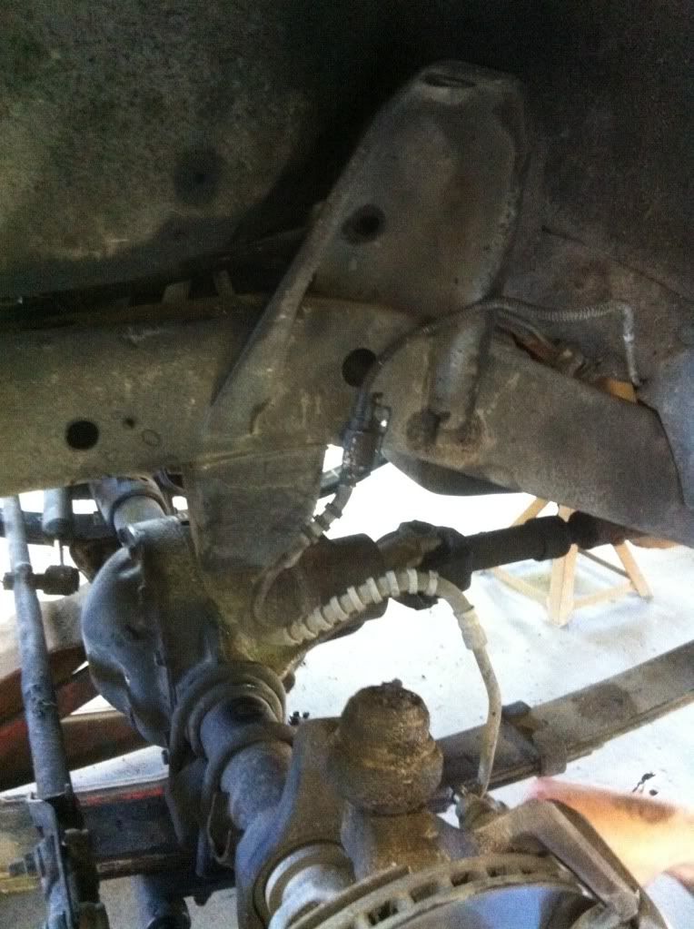

Does anybody know of a good write up on brake line extending??
Yep. A free one.
Just make your passenger side look like this:
And the drivers side look like this:

Is there enough slack in the line behind the frame to just be able to pull it down like that or do I have to extend the line behind the frame?

On the passenger side you just pull it straight down from the top of the frame to the existing hole in the frame for the splash guard. The drivers side is a bit tricky and requires unbolting the caliper and maneuvering it between the shock and frame. It's easier because you save time in the bleeding department.

You'll need a pilot hole on the drivers side.

Is it bad to leave it loose or could I just unbolt it and be done?

You'll want it secured to t frame just in a different spot than what jeep engineers originally designed. Use the same mounting brackets and the same screws provided and drill one small pilot on the drivers side to accommodate the above shown configuration. That one doesn't look as pretty but we did AmmitOsiris' last Saturday and it's much prettier. The length is more than adequate and it's FREE!
