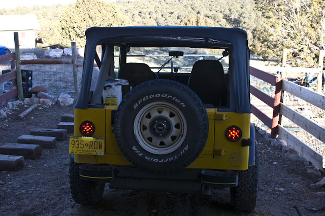

Well, I made a license plate light after installing the LED flush-mount taillights, in the necessity of legality.
A bit of scrap metal, LED strip light from AutoZone and some JBWeld and this is what I got:
The plate JB welded to the license plate frame:
LED strip light adhered to the metal plate beneath:
The wire disappearing into the body to marry up to the park light wire to the taillight:
Final product:
Almost looks like it's supposed to be there.
