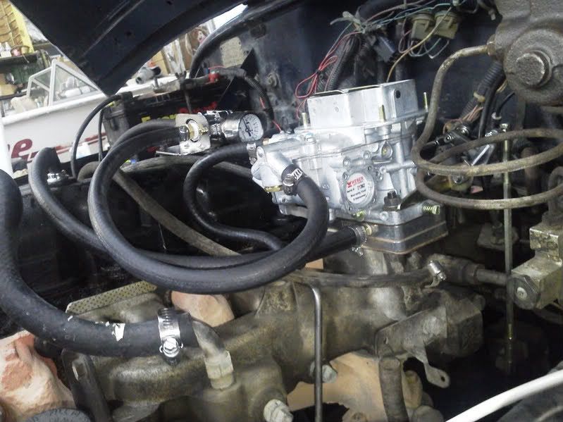

A picture of your linkage setup would be a great help.

ok here is the linkage with the filter off sorry if pic is bad ill try to get another one up

I see an engine bay with many of the parts that are found in one, a good portion of a fairly good size garage with a boat inside it... then over here we get an obscured view of a rod.

x2, you can get in there and grab some good pics.
