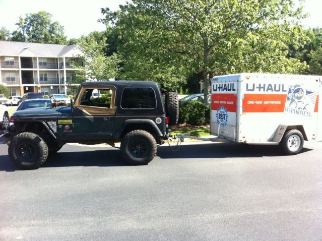

I've made a couple trips from Atlanta to Knoxville towing a 5 x 8 U-haul trailer that was loaded down. It wasn't that great but it saved me a lot of money doing it that way. My main issue was keeping the engine cool and making sure I maintained my lane when going through Downtown Atlanta. I also run 4.10's with 33's and a 4.0L.
just to note, U-haul won't let you rent a trailer if you have a softop. Ask me how I know.
