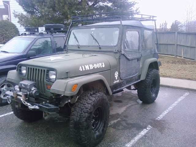

Purchased the jeep in 06' after it was in an accident. Got it running in the summer of 07' then realized at the end of summer that my frame was going to need replaced instead of patching every bit I could.
Doner frame out of an 89 sahara. $200 at the junkyard

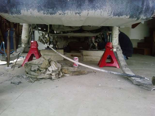

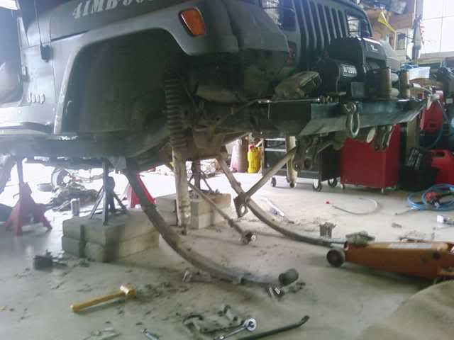

Start of the tear down Feb of 07'
Rebuild started beginning of March 07'
Started to Paint
Jeep originally had 37's with 3.07 I steped it down to 35's then eventually down to 33's
As of a month ago I swapped in a 8.8 lsd and a built hp d30 with cromoly shafts/ Aussie locker and 35" MTRs

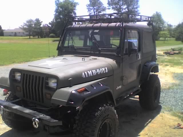

As she sits now
I know after doing this every part of my vehicle through and through. My suggestion if you need to replace a frame... FIND A NEW JEEP! lol

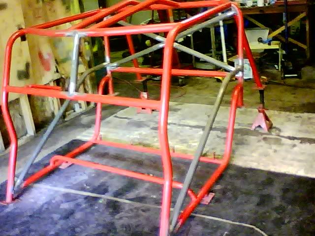

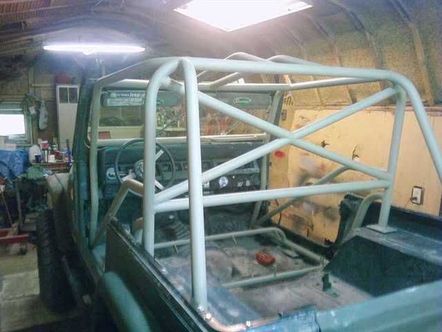

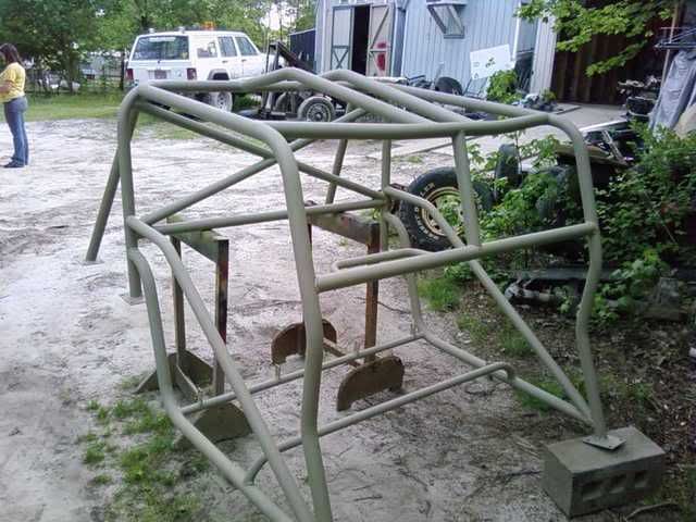

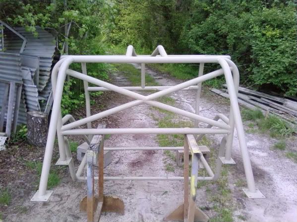

I picked up a cage built by a local shop that builds monster trucks. It was installed in another jeep when I picked it up. Used but never tested lol. I liked the overall build but I thought it needed some more. It came with 2 corbeau full suspension seats and 2-5 pt harnesses. Its an 8 point cage. The cage will be getting tied into the frame on all 8 points. Here are some pics.
The new bars installed. The red parts are the cage before the extra bars were put in.
Then I sanded and painted the whole thing. The cage was painted with Krylon ultra flat Khacki.
I will post pics as the install comes along. Will possibly have it done by the end of the week.

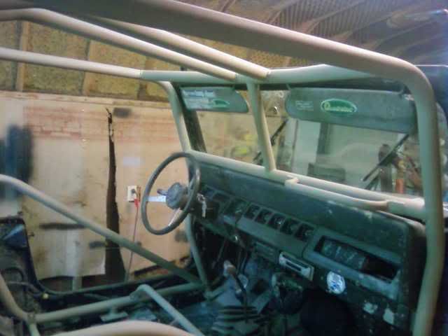

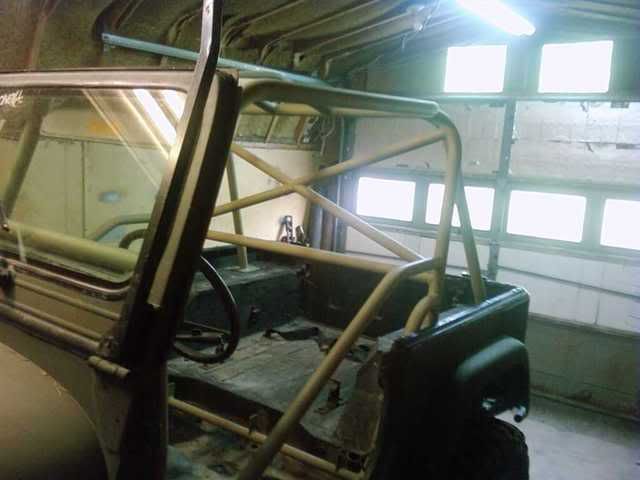

Mocked it into the jeep. Still need to do some modifying. Looks like the dash pad will be getting pulled out to get it to sit down all the way. Will post more pics as the install comes along.

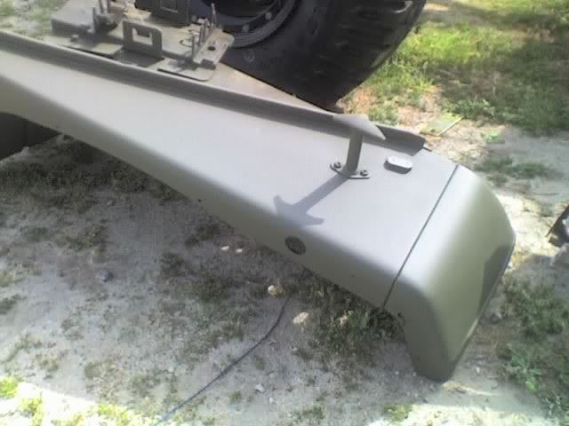

did your rear corners affect the tj flare swap as far as getting in the way with grinding?
tato1111 is offline
post #14 of 26 Old 05-11-2009, 07:57 PM Thread Starter
VamosJEEP
Location: Delaware
Posts: 433
Thanks Trashman!
The corners are aluminum. More for show than anything else so they were easily trimed.
