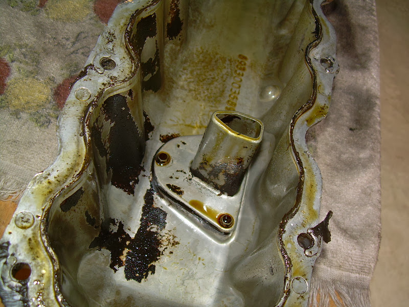

Clean the gasket off the aluminum cover. Pull the vent risers and clean all the carbon out of those. Mine were not plugged, but some will be and your PCV/CCV won't work right if they are clogged. You can see the Felpro rubberized gasket in the background.
This is NOT cleaned yet. All that old gasket gunk has to be completely cleaned.
