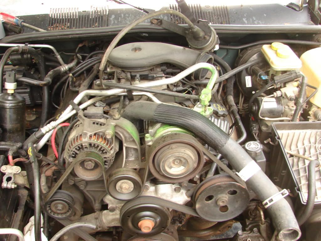

awesome pics of the mounts. much better views than the other thread we saw. maybe you can find the power steering bracket off a similar motor that i am using. it pulls the pump much closer to the block than the one you are using.

Ah the cash for clunkers green spray paint, gotta love that huh?
I considered that but the only one I could find didnt have a reservoir attached and I couldnt find one in the yard to replace it so I just went with the one I could find. It works, I can fit a finger between it and the steering shaft with no problems and it worked out having the motor shifted that inch to the passenger side. It also made finding a belt easier, as there wasnt an option listed for ZJ w/out AC and an AC belt wouldnt have fit. With my setup I ordered one for a 93 Dakota (3.9,5.2 doesnt matter) and it went on like it belonged.

no c.f.c auto here. it was a daily driver that a friends mom wrecked like a week before i got it. he needed the tins and interior from it and i wanted everything else (not bad for $150 huh?). actually it's the dye inside the a/c refrigerant to help you find leaks. i was told it was discharged, well just before this picture was taken i learned otherwise. i will be leaving the compressor there for conversion to oba.
