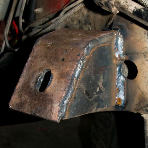

Here are some pictures of my motor mounts pre-painting and engine reinstall. I made them out of 3/16th plate we had laying around which is more than enough (and the same thickness as the frame).
Here is the front of the passenger side motor mount: notice no extra bulk, all the strength that could be needed and it looks good too!
Here is the back side of the passenger side mount:
Here is the front of the Drivers side mount: note that it looks like the hole in the frame made my weld weaker, but I was able to weld to the inside of the hole which will give me back most of the little strength that was lost.
And the back of the drivers side mount:
Notice how the drivers side is longer than the passenger side: This is to shift the motor over in the frame about 1" to give me clearances for power steering and everything else snaking around under there.
Nice Welds!!!
