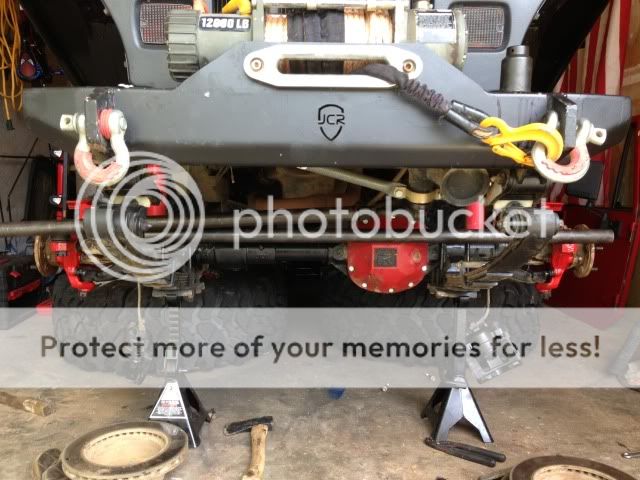

So I just picked up and painted the knuckles and pitman arm now it nine to cut and weld the tre and draglink, hers a couple pics of how it will sit (ish). I hope going otk works out for me!

I am trying to measure for the Dom and am not 100% sure on the lengths so can any one compare? This otk with out the weld in bungs just Dom length, draglink 22.25 inches and tre 40 inches!
If your real worried about it just mock it up with pvc. its cheap and won't hurt your wallet as much as screwing up the dom.

Nah it will work out its at the shop getting cut up now!
