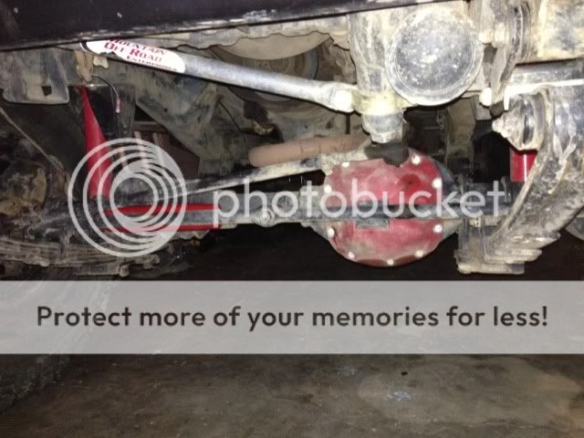

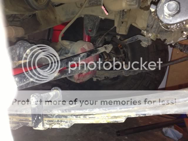

So I don't mind if I have to find or order a stock Yj or flat arm, but could a guy flip the tirod at the pitman arm to gain more clearance? I plan on the ruff stuff kit which has 1 ton joint any ways for I have to cut and ream the knuckles and pitman arm any ways........ Here are a couple pics of my current stock set up (don't mind the slightly bent tierod) let me know if you guys think the otk will work, I would hate to order it and no have room for it!

It looks to me like youd have plenty of room to run OTK but you could flex it out and see how close everything is now to get a better idea. I ran OTK when I had a dana 30 with a stock yj pitman arm but with heims similar to the RS kits. You could mount the TRE to the top of the pitman if you really need to.
