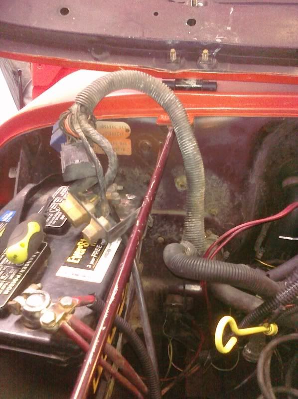

Anyone know what these blue relays are? I have an 88 YJ and in the process of a Post nutter de-wiring and unclutter of the engine bay. I eliminated the wires from the computer back but these tie in but cant find anything to definitively say what they are or if I can remove... thanks for the help. I need to get this figured out so I can start driving.. I just hate to leave extra wiring I don't need anymore..
Anyone know of a Post Nutter wiring write up on an early YJ on here? I may have missed it if so...

worse comes to worse pull one relay and see what doesn't work? maybe an alarm system from the old days or something? wire didn't look big enough to power lights, but could have been?

Thanks... looks like I can get rid of all of that then based on the other post link. Is this assumption correct.
I was thinking I need the manifold heater but then I realized the plug was cut anyway and not being used. Anyone suggest keeping the manifold heater if all the emissions elements are gone from the nutter bypass?
One last question.. there is a wire going to the side of my weber carb.. I believe electric choke maybe.. during the dewiring the wire fell off. what do I reconnect it too?
