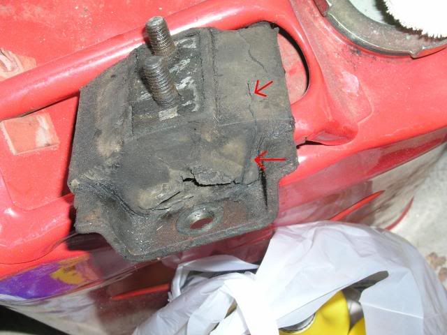

Are you just hearing it or do you feel it? You only replaced one motor mount (I would do those as a set), what about the trans mount?

Don't think I am feeling it, but only hear it on gravel in need of grading. We only replaced driver's side. Passenger side looks ok visually. Also, when we picked up rear axle and mm from our fav used parts shop guy, we had our jeep with us. We asked him if he was sure that only the driver's side was bad, because we were happy to buy both. But he reassured us only driver's side was bad. Tranny mount looks ok. That was the first thing I checked, because I had read that if mm bad, then good chance tranny mount could be bad.

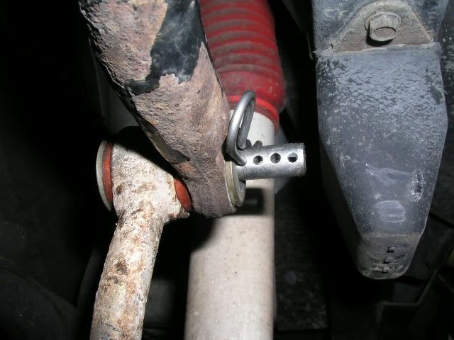

Checked exhaust mounts, mm, tranny mount. Checked u-joints/ball joints. Jacked tire up on each side and checked for play and bolts tight. Noted sway link end is funky. Not sure how to check steering stabilizer, but it looks old. Took turns driving in slow tight stop/start circles while other watched. Took turns jumping on bumper. Noted track bar bracket not good.

Well, the good news is that your Jeep won't mind you removing both the track bars and the stabilizer in your effort to find the source. Bouncing didn't replicate the sound huh? Should be able to eliminate a faulty shock as well then.

This was one of my mysterious clunks. The trans mount is hard to see when it's still mounted.
And it started out with a bad drivers side MM.

Thanks for the replies! Just to be safe, we will definitely replace tranny mount today, even if it is not source of clunk. Come to think of it, the clunk sounds very similar to how my accord did when it had a bad sway link end. Will have to redo jumping on bumper, with a specific eye on the sway link. Don't think I did that before.

Remove the track bars and the sway bar links. Take it for a drive. Make some turns at speed. If you're ok with the sway, then don't bother putting anything back on. If you're not ok with the sway, put the sway links back on. Repeat drive.
I like my sway bar attached, unless I'm wheeling. Probably because of my driving style. So I made some quick disconnects for the sway links.
