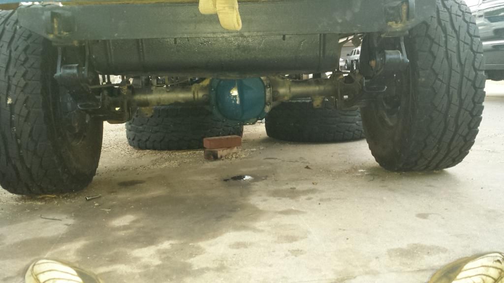

One comment above about the shock mounts still hanging down low is spot on. This mod would be even better if you rotate up the shock mounts. I used MORE upper shock mount relocation kit, which allows a lot more clearance. You can see my setup below. I used the Dynatrac kit, but love the Chevy $20 kit:
Nice, I also raised my shock mounts when I did the 8.8.

Here's a picture of both done.
That looks clean!
