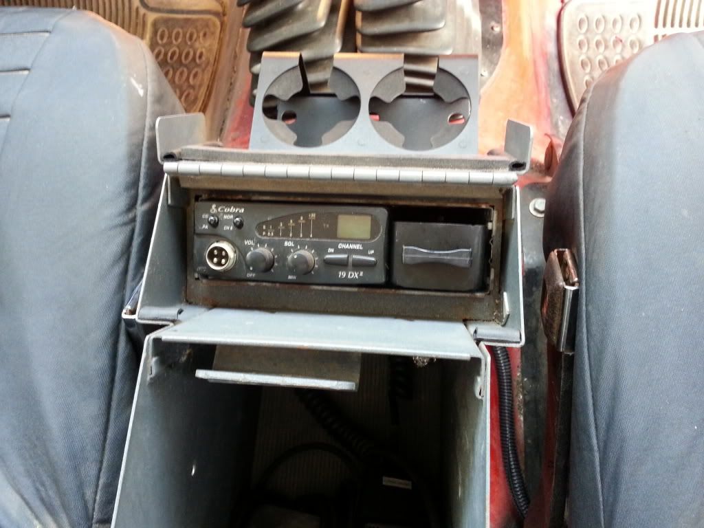

20mm Ammo can

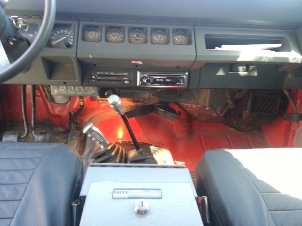

I used to have a VDP 8" wide console and then picked up this 6.5 Tuffy. I do miss the extra room in the other console but this make finding things between the seats a lot easier and you can always fit larger seats

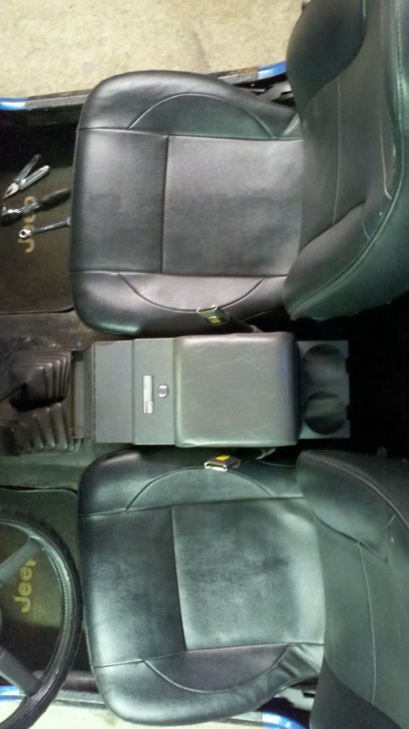

I had a Tuffy 6.5" with the 8" stereo head for 10+ years. The photos above make it look like it's all a perfect fit, but as some have said, in your 95, the 8" part will rub the seats pretty badly, and over time transfer paint and wear out the seat. Unlike the photos above with a CB in there, I used a DIN stereo, and got to like it there a lot. Because of the seat issue though, I sold my Tuffy last summer for $80 and bought $40 worth of steel to make a 16 gauge box of my design and to make the bending brake needed. Now I have a custom console and a new tool on the shelf, and change left.
If you can weld and have some design imagination, figure out what will be best for you and go for it.
Here is mine. The partly visible piano hinge hides a flip over cover for the stereo if I want to lock everything, but I usually just lock it as shown. I had some brown leather left from another project. I got the lock and keys from Tuffy for $12 or so. The angled front part is a removable panel to easily add options. The red stereo part is held in with slots and one wing nut to make for stereo wiring easy (hated the Tuffy for that).
